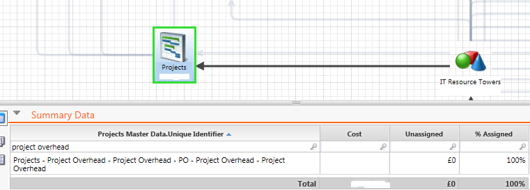

    I have a line on the model summary data which says it's 100% allocated but when I trace it on the model it doesn't actually go anywhere. Anyone know why this could be?

    Hi Ryan, please see below - there is cost but I've removed the values. As you can see the data/cost is 100% assigned but it's not actually going anywhere on the trace

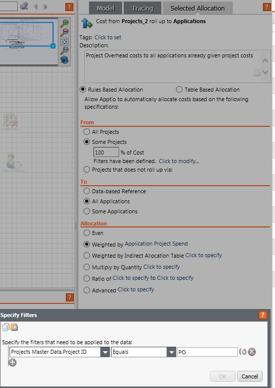

    It's flowing from ITRT but my question relates to Projects to Apps - it states 100% but isn't flowing to Apps

    Posted 03/28/17 06:49 AM
    There is no application, the allocation line is taking our Project Overhead cost and spreading that cost across all applications which already have project costs using a new metric.
    The money is getting to these projects as the Project Overhead is showing up on all the Project and App related reports just not showing up on the trace.

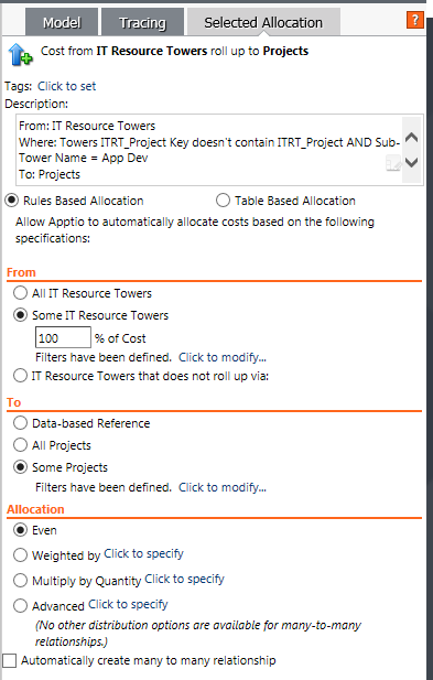

  • 10.  Re: Allocation Confusion!
    Posted 03/28/17 07:02 AM
  • 11.  Re: Allocation Confusion!
    Posted 03/28/17 07:11 AM
    Ah, Julie, do you have the one from ITRT to Projects?  That was the one you were trying to do the trace on and it wasn't showing anything
  • 12.  Re: Allocation Confusion!
    Posted 03/28/17 07:16 AM
    The costs are coming from Towers but once at Projects the trace isn't showing the allocation

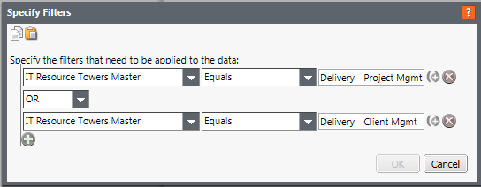

    Allocation:
    From Filters
    To Filters
  • 13.  Re: Allocation Confusion!
    Posted 03/28/17 07:36 AM
    Thanks I don't see anything that would cause the trace to not function.  The only other question is are you doing this in DEV?  If so, it could be that it's taking some time to calculate and\or there could be a cache issue depending on changes and the number of traces that have occurred.
