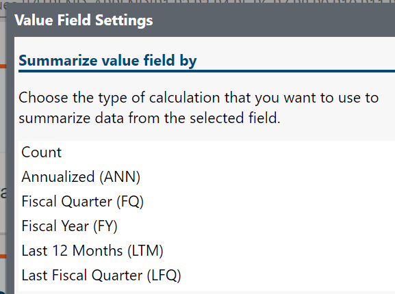

    If instead you want to see the total for the entire previous fiscal year (regardless of which time period is selected by a user at top center of screen), consider Apptio's built-in time options per metric: Right-click Cost in the Values section of the ad hoc query configuration dialog, then Value Field Settings > Last Fiscal Year, seen here:
    The Value Field Settings options also include Last 12 Months (rolling look-back) to save you the trouble of creating a 12-piece TimePeriod() formula.

    Thanks, Chris!  Is there a way to duplicate the current OpEx and CapEx columns we have in here for this current fiscal year so I can edit them appropriately in the Value Field Settings?  I need to have both FY16 total and FY17 YTD.

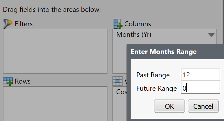

    I'm after a rolling 12 month view of some MIPS usage, and I've done the calculation that you said above TimePeriod(MIPS,-1)+... and I was wondering if there has been any improvements to the way this can be done? As in, is there a Rolling12Months(MIPS) type formula I can use, or is the only way to do all of the time period calcs?

    To display one column per month (Example: 12 columns to show 12 months), drag Months (Yr) from Time perspective to Columns section of ad hoc query configuration dialog. Then right-click Months (Yr) > Range to adjust the look-back (or look-forward) distance.

    If you specifically want a 12-month look-back, the above posts show a shortcut using Value Field Settings > Last 12 Months (LTM).
