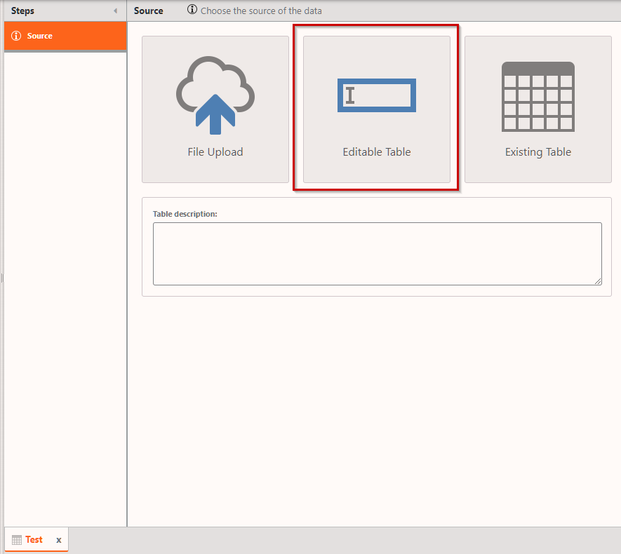

    Hi everyone
    I'm looking to add a row to a reference data set in Vendor Insight. To save myself time I'm trying to add this row within Apptio rather than in the source application before uploading my reference data every month.
    Is there way I can achieve this internally within Apptio? I can't seem to do it using formulas (circular reference errors) so instead I looked into using an editable or enriched table. The editable table allows me to add this row but I can't find a way to append it to the table containing the rest of the data. I' tried using an enriched table but this doesn't allow me to add an additional row so seems to also be redundant.
    Any input is greatly appreciated. Thank you !!

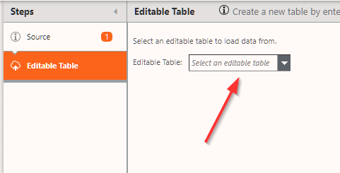

  • 3.  Re: Adding an additional row to a reference table
    Best Answer
    Posted Mon March 09, 2020 11:34 AM
    You can do this using an editable table. The trick is that when you create the Editable Table initially, you also have to create a "normal" table where the source is the editable table that you created. Once creating that second table, you can then append that one to the reference data set that you need it in.
    1. Create editable table ("Table Name Editable Table") and configure columns/data
    2. Create "normal" table ("Table Name"); source = "Table Name Editable Table"
    3. Append "normal" table to reference data set
    Hope this helps!
