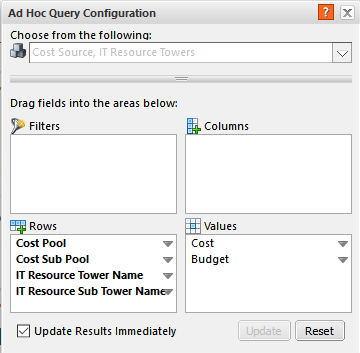

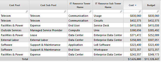

    Hoping someone can shed some light on this one.  Trying to create a simple ad hoc report that shows dollars hitting Towers, Sub-Towers, and Cost Pools - is that possible?  I've tried creating separate perspectives, etc., but it doesn't seem to want to play nice.   Want to see what amount of dollars per cost pool is feeding what sub-towers that ultimately feeds the towers if that makes sense...  We sometimes get questions about the cost of servers or storage and we want to break out the baked in parts...

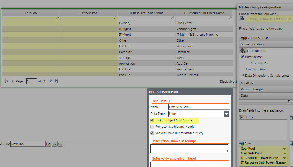

    The table above was created by combining:
    Cost Pool and Cost Sub Pool (both locked to Cost Source object)
    IT Resource Tower Name and IT Resource Sub Tower Name (both locked to IT Resource Towers object)
    Cost and Budget (metrics, found in the Calculations perspective)

    Christopher, you're awesome - thank you so much!!!

    You still rock, but I can't get it to work on my end.

    If you remove the tower and sub-tower columns, do the Cost Pool and Cost Sub Pool columns have values?

    If you haven't already, try also adding the Cost metric (from Calculations perspective) to the Values section of the ad hoc query configuration dialog.

    @Chris Davidson, adding Cost worked - thank you!!!!
