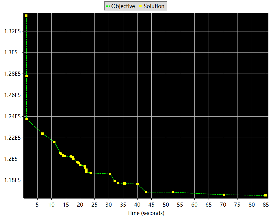

    I am working on a multi-commodity flow problem with about 29 orders, 50 arcs and 150 services on my transportation network. I find CP optimiser can find good solution in first 50 seconds, and cannot reduce the gap after 85 seconds. I think the process which proves the current solution is an optimal solution is really time-consuming. So do you know who to reduce the running time? like adding cuts?

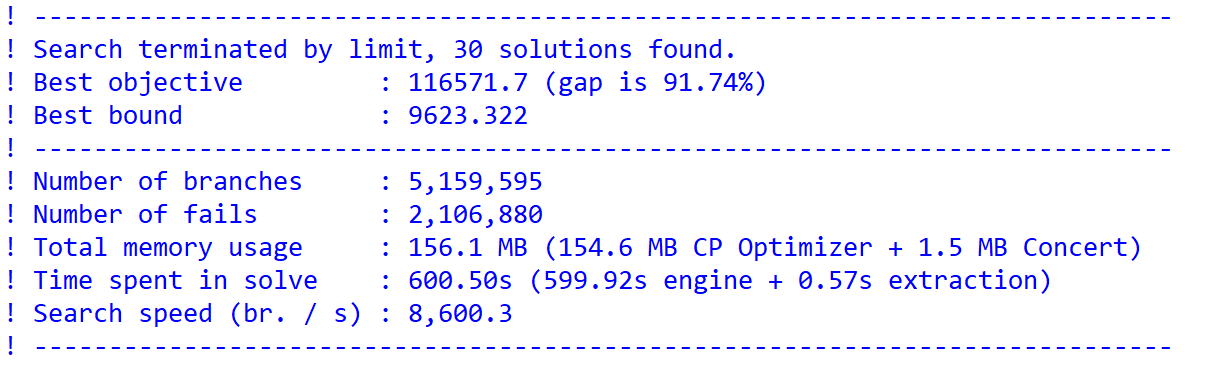

    Attachment is the output of 10-min running. I also did a 3-hour running, it cannot find another solution after 85 seconds. Is my problem too complex to consume lots of time? or is there something wrong with my code? Should I use decomposition or other method to accelerate my optimisation?
