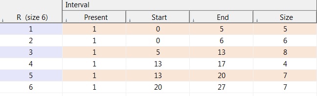

  • 2.  Re: A question about alwaysEqual
    Posted 03/02/19 01:04 PM
    Hi,
    you have a C++ example at
    https://www.ibm.com/support/knowledgecenter/en/SSSA5P_12.8.0/ilog.odms.cpo.help/CP_Optimizer/reffileformatcpo/functions/alwaysEqual.html
    and that can be written in OPL:
    using CP;
    range R=1..6;
    int sizes[R]=[5,6,8,4,7,7];
    int temperatures[R]=[0,0,0,1,1,2];
    dvar interval itvs[i in R] size sizes[i];
    stateFunction temperature;
    cumulFunction nbParallelActivities=sum(i in R) pulse(itvs[i],1);
    subject to
    forall(i in R) alwaysEqual(temperature,itvs[i],temperatures[i]);
    nbParallelActivities<=2;
    which gives
    regards
    https://www.linkedin.com/pulse/ibm-think-ai-optimization-me-alex-fleischer/
    #DecisionOptimization
  • 3.  Re: A question about alwaysEqual
    Posted 03/02/19 08:12 PM
    Originally posted by: hzwpku
    Thank you very much.
    The solution of the above model is:
    itvs = [<1 0 5 5> <1 0 6 6> <1 5 13 8> <1 13 17 4> <1 13 20 7> <1 20 27 7>];
    The main difference is that the processing time of one batch is equal to the longest processing time of jobs in that batch.  When the first two jobs are assigned into
    the same batch, the processing time of the batch should be 6, and all the jobs' duration in this batch should also be 6. The actual job processing time is dependent
    on the batch form.
    How to deal with this situation?
    Best regards!

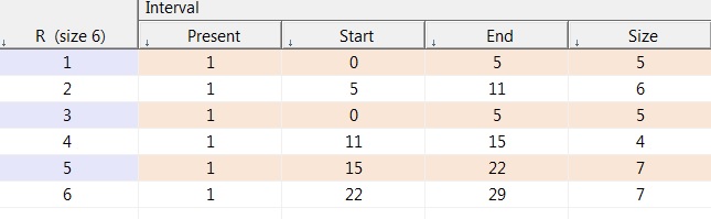

  • 4.  Re: A question about alwaysEqual
    Posted 03/03/19 07:12 AM
    Hi,
    to go on with the previous example, you could say that 2 intervals that overlap have the same lenth:
    using CP;
    range R=1..6;
    int sizes[R]=[5,6,5,4,7,7];
    subject to
    forall(ordered i,j in R) (overlapLength(itvs[i],itvs[j])!=0) => (lengthOf(itvs[i])==lengthOf(itvs[j]));
    which gives
    regards
  • 5.  Re: A question about alwaysEqual
    Posted 03/03/19 08:04 AM
    Thanks!
    The idea  to make 2 intervals that overlap have the same length may work.
    At first, I describe the problem more clearly. Each interval has a size which is given, such as the above example: [5,6,5,4,7,7].
    But when two jobs with different sizes are in same batch, the lengths of these two jobs are equal to the larger size between these two jobs, such as job 4 and job 5 can be assigned into
    one batch, the lengths of these two jobs are equal to 7 (the larger one between 4 and 7). The following solution is better than the above solution.
    R     Present  Start  End  Size
    1      1            0          5       5
    2      1            5         11      6
    3      1            0          5       5
    4      1            11        18      7
    5      1            11        18      7
    6      1            18        25     7
    Best regards!

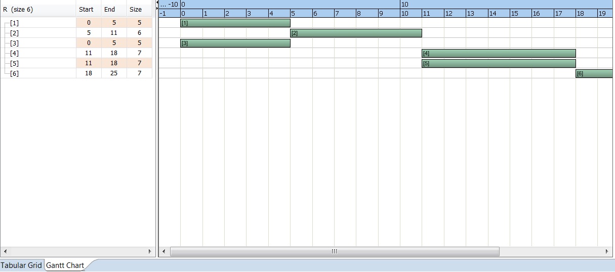

  • 6.  Re: A question about alwaysEqual
    Posted 03/03/19 11:59 AM
    Hi,
    then instead of setting the sizes of intervals you may set minimal values:
    using CP;
    range R=1..6;
    int endHorizon=1000;
    dvar interval itvs[i in R] size sizes[i]..endHorizon;
    minimize max(i in R) endOf(itvs[i]);
    subject to
    gives
    regards
    https://www.linkedin.com/pulse/making-decision-optimization-simple-alex-fleischer/
