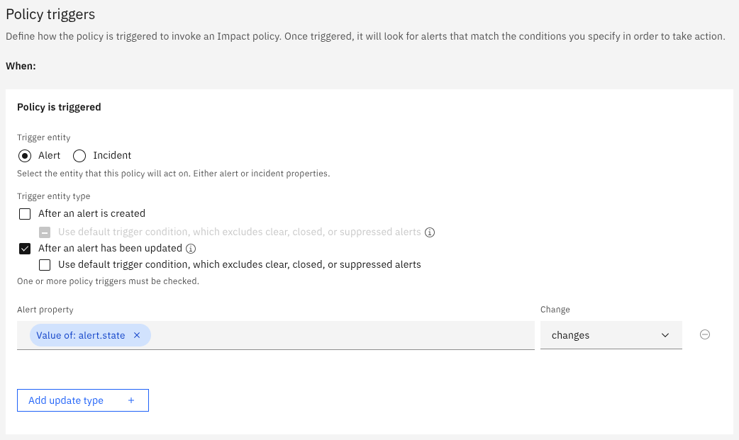

Set up your Policy triggers section as follows:
NOTES:
  • Give your AIOps policy a name - for example: Clear OMNIbus event
  • Trigger entity should be Alert as we are clearing on a per-alert basis in Netcool/OMNIbus
  • Trigger entity type should be set to After an alert has been updated since we are performing this action when the alert is cleared in AIOps
  • Uncheck the Use default trigger condition since we want to perform this action specifically for cleared alerts in AIOps
  • Set Alert property to Value of: alert.state and set Change to changes

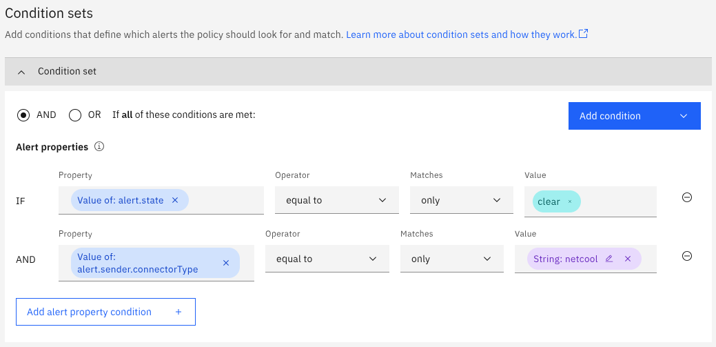

Set up your Condition sets as follows:
NOTES:
  • Ensure AND is selected since we want both of the criteria to be met
  • Add conditionAlert property: Value of: alert.stateequal toonlyclear
  • Add conditionAlert property: Value of: alert.sender.connectorTypeequal toonlyString: netcool
  • These conditions ensure only newly cleared alerts are processed and only ones that have originated in Netcool/OMNIbus

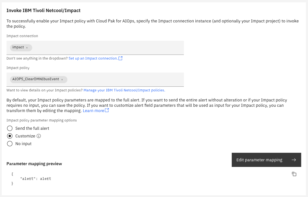

Set up your Invoke IBM Tivoli Netcool/Impact as follows:
NOTES:
  • Select your Netcool/Impact integration in the Impact connection box
  • Select your Netcool/Impact policy that you created earlier in the Impact policy box

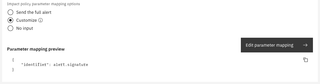

  • Choose Customize under Impact policy parameter mapping options
  • Click on Edit parameter mapping to customise your parameter mapping
The alert.signature attribute in an AIOps alert holds the Identifier field of the event in Netcool/OMNIbus. We therefore need to configure the mapping to pass this attribute to the Netcool/Impact policy we have made by customising the parameter mapping so that Netcool/Impact can access the event in Netcool/OMNIbus.
Configure your parameter mapping as follows:
NOTES:

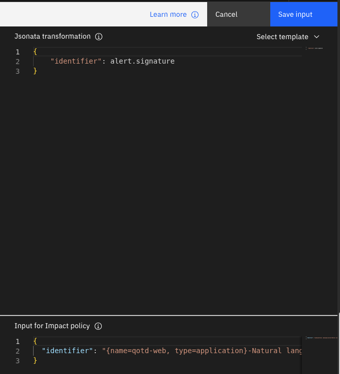

  • Configure your Jsonata transformation to include a single parameter called identifier that maps to alert.signature
  • View the sample result in the Input for Impact policy section
  • Click Save input to save your mapping
Your Parameter mapping preview should now look like the following:

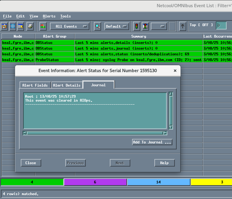

Test out your new clearing mechanism by opening an Event List view into Netcool/OMNIbus via either WebGUI or by starting the Native Event List client, then clear one or more Netcool alerts in AIOps and inspect the results.
  • Open an Event List view in Netcool/OMNIbus - for example: $OMNIHOME/bin/nco_event -server AGG_P -user root
  • Filter on clear events in your Netcool/OMNIbus Event List view
  • Navigate to the AIOps Alert viewer by selecting Alerts from the main AIOps hamburger menu
  • Identify an alert that originated in Netcool/OMNIbus and clear the event via the AIOps Clear tool
  • Observe the alert in AIOps change to a Clear state
  • Observe the alert change to clear in the Netcool/OMNIbus Event List view (Severity = 0)
  • Inspect the journal to see the journal entry added by your Netcool/Impact policy
If everything is configured correctly, you should see something like the following:
