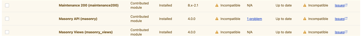

If updates are required for your custom module or theme, you'll see a link to the corresponding themes or modules once the scan is complete. For instance, the image below demonstrates the process of scanning an installed custom module named Masonry API.
Viewing issues identified by Upgrade status module
