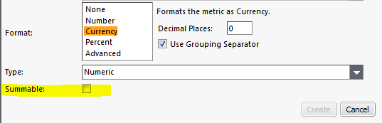

    I have a table that has a handful of numeric columns in it.  I have the Total Row option selected to show the total for each column.  The problem is, one of my columns should not be totaled because the sum of all the values does not make sense in the context of the report.  Is there a way to turn off the summarization for this one column?
    My first thought was to create a new column that referenced this column, and then leave the "Summable" option unchecked.
    This did not work, and I'm not sure why.  If this doesn't produce a column that does not have a summary value, I'm not even sure what this option does.

    So in order to do this you should set the Type to "Label" and it will not total up using the Total Function within Apptio:
    You can also set it to a number and change the formatting (i.e. Decimal Places) and then set it back to label, therefore you have the formatting of the number that you want but it won't be included in the Total Bar at the bottom of the component:
