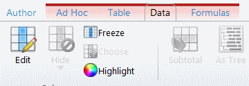

1. Switch to report editing mode.
2. Click the Project Manager column header to highlight the entire column.
3. On the Ribbon, click: Data > Edit.
(Is Edit grayed out and unselectable? Try: Ribbon > Data > Insert > Insert Formula Column and then create a new column whose formula is equal to the old column.)
4. In the Enter Formula field, surround the column's existing value with HTML and CSS. For instance, to change this column's text color to green and size to extra large, enter:
