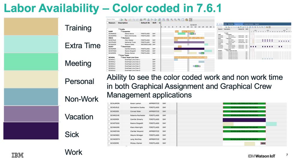

Ability to show person and crew modify availability reason codes in different colors in Graphical Assignment - Assignment view
  • system properties are used to accomplish new colors, the following is the values used below
    • skd.modavail.color.EXTRATIME    color for extra time reason code    #b0ecde
    • skd.modavail.color.MEET                color for Meeting reson code          #79e5b2
    • skd.modavail.color.PERS                color for Pers reason code               #eae8c6
    • skd.modavail.color.SICK                 color for Sick reason code               #311151
    • skd.modavail.color.TRAIN              color for Training reason code        #dfc78e
    • skd.modavail.color.VAC                   color for Vacation reason code       #8c769f
  • remember new reason codes can be added to the ootb values such as Meetings and Training below (Domain RSNCODE)
Color coding for labor availability
  • system properties are used to accomplish new colors, the following is the values used above
  • remember new reason codes can be added to the ootb values such as Meetings and Training above
