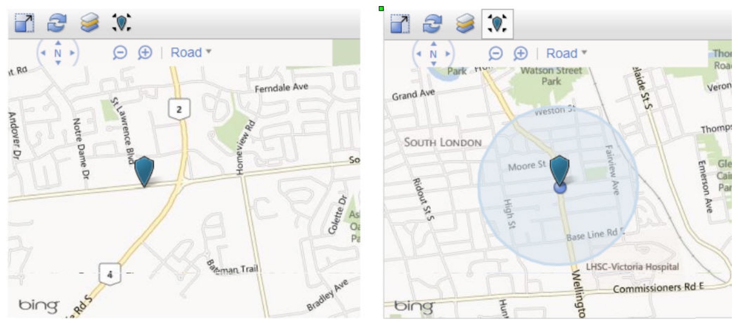

Besides all existing map functionalities that the GISable MBO had, by implementing these CombinedLBS methods on a MBO, it will also be possible for a custom map tool to switch the source of positional information so that LBS data can be used instead of GIS data.

The changeLayerLatLngSource event is used to tell the Map component which source of positional data should be used when displaying a CombinedLBS MBO (false is the default value and tells the Map component that it must use GIS data; true tells the Map component that it must use LBS data).
Assuming that the MBO was a GISable before, a Map tab is already available for the MBO application. So, in Application Designer, add the tool to the Toolbar items field of the map properties.
That is all! When the map is loaded in the Map tab, the new tool will show up in the toolbar. If the tool is turned on and one or more records do not have LBS data available, an error message will be displayed.
When a CombinedLBS MBO is being displayed on the Map using its LBS data, only the following attributes are taken into account when drawing the marker:
  • LATITUDE and LONGITUDE (used to pinpoint the position of the marker on the map);
  • LOCATIONACCURACY (radius - in meters - used to draw the accuracy circle around the marker)
  • LASTUPDATE (used to select the color of the “age” indicator of the marker)
The HEADING, SPEED, ALTITUDE and ALTITUDEACCURACY attributes are not being used by the Map component in Maximo Scheduler 7.5.2.
Figure 1: Example of a tool that toggles between the Asset's GIS location (to the left) and LBS location (to the right).
