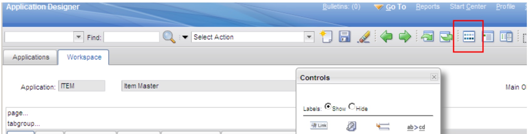

On the Workspace loaded with the Item Master application design open the Control Palette using the toolbar menu:

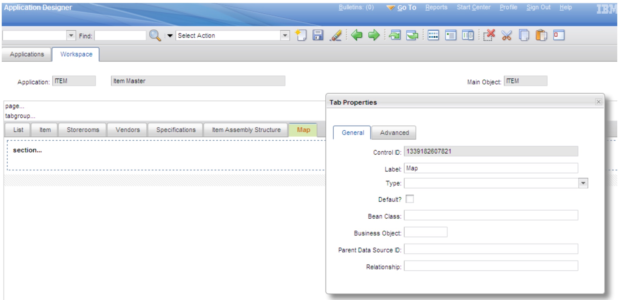

Use the Control Palette items to create a new tab (using the Tab control), click on that newly added Tab and add a section inside the new tab. You can also click on the new tab properties and set its label to "Map".

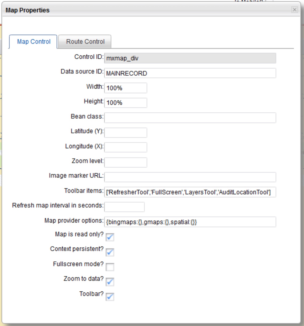

The Map Control has properties that allow users to deeply customize this component. See references for the links to the documentation of all the properties.
To enable the ability to set a marker on the map edit the map control and uncheck the Map is read only check box

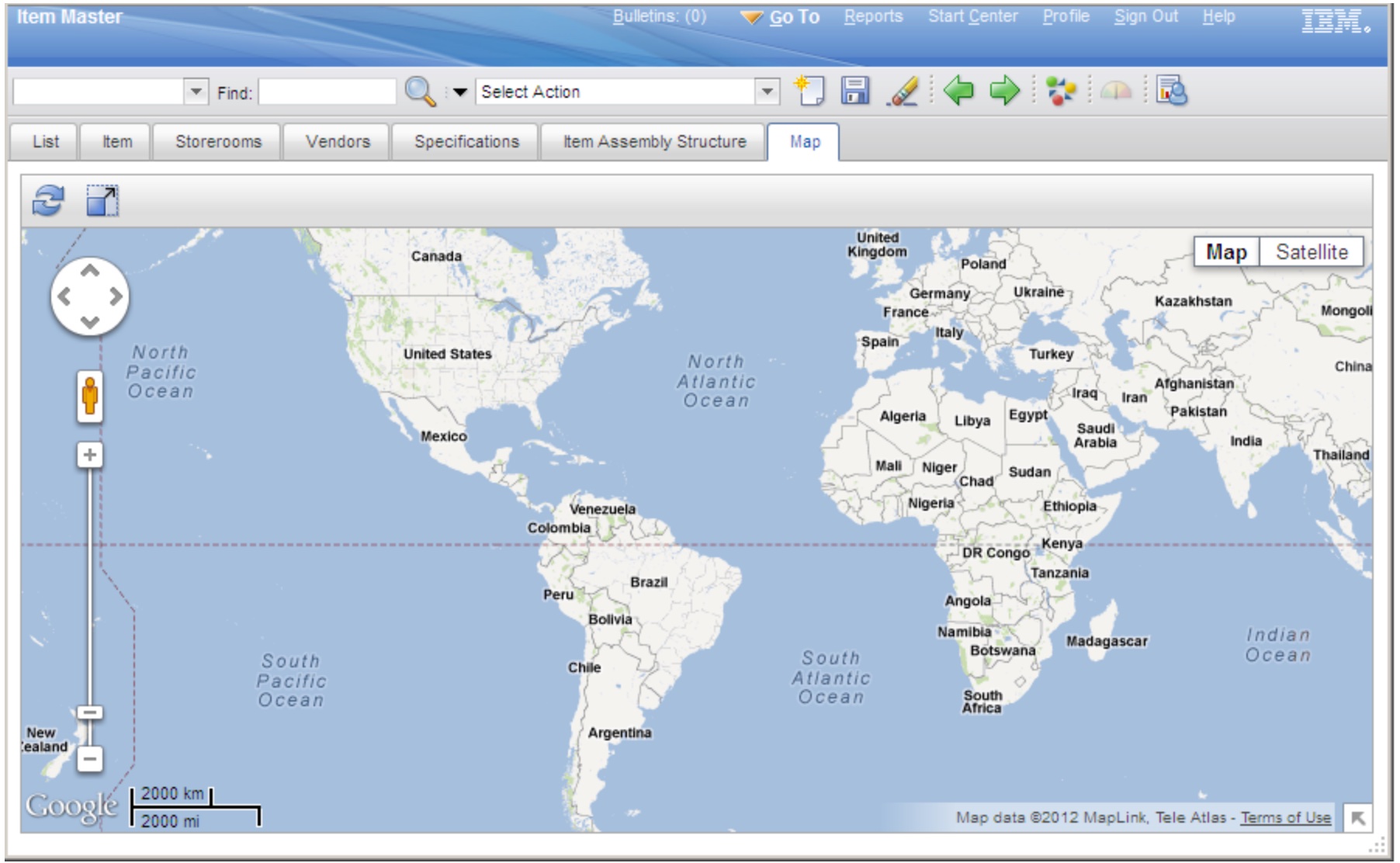

Having a valid Map Manager configuration go to Item Master application (Go to -> Inventory -> Item Master). Open a record and click on the Map tab.
The Map is added to the application.
