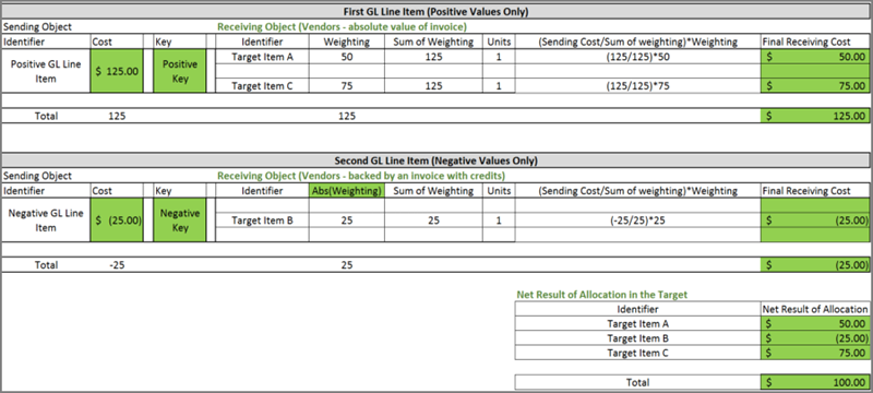

Segregate negative source values and weight by absolute values
Another strategy for dealing with negative values is to segregate them in the source and use the absolute value to weight. In the following example of an invoice with credits, the total (including the credits) is installed in the General Ledger as a single line item with the sum of $100. It is then allocated to the Vendors object (to support out-of-the-box reporting) weighting by the values in the invoice. Because the invoice includes credits, we get incorrect numbers in the target.
If instead we segregate the credits in the General Ledger/cost source and insure that the data relationship/key preserves the segregation, we can then use the absolute value of the invoice including credits:
This results in accurate numbers in the target.

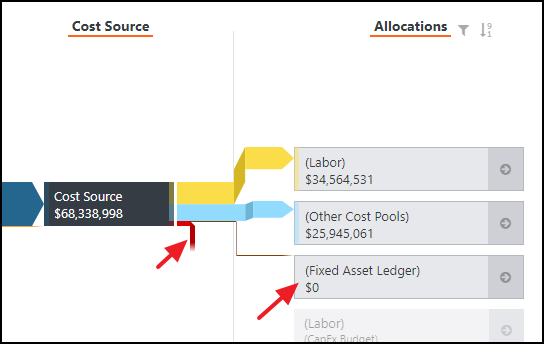

Here, we see an allocation from Cost Source to Fixed Asset Ledger that is not functioning, and the user is aware of that:
When the allocation is examined more closely, the issue is not obvious:
However, when we sort Cost Pool Weight in ascending order, we see two small negative values:
NOTE: Because it isn't always obvious, it is recommended to check weighting columns by sorting in ascending order if you find an allocation that appears to be correctly configured.
