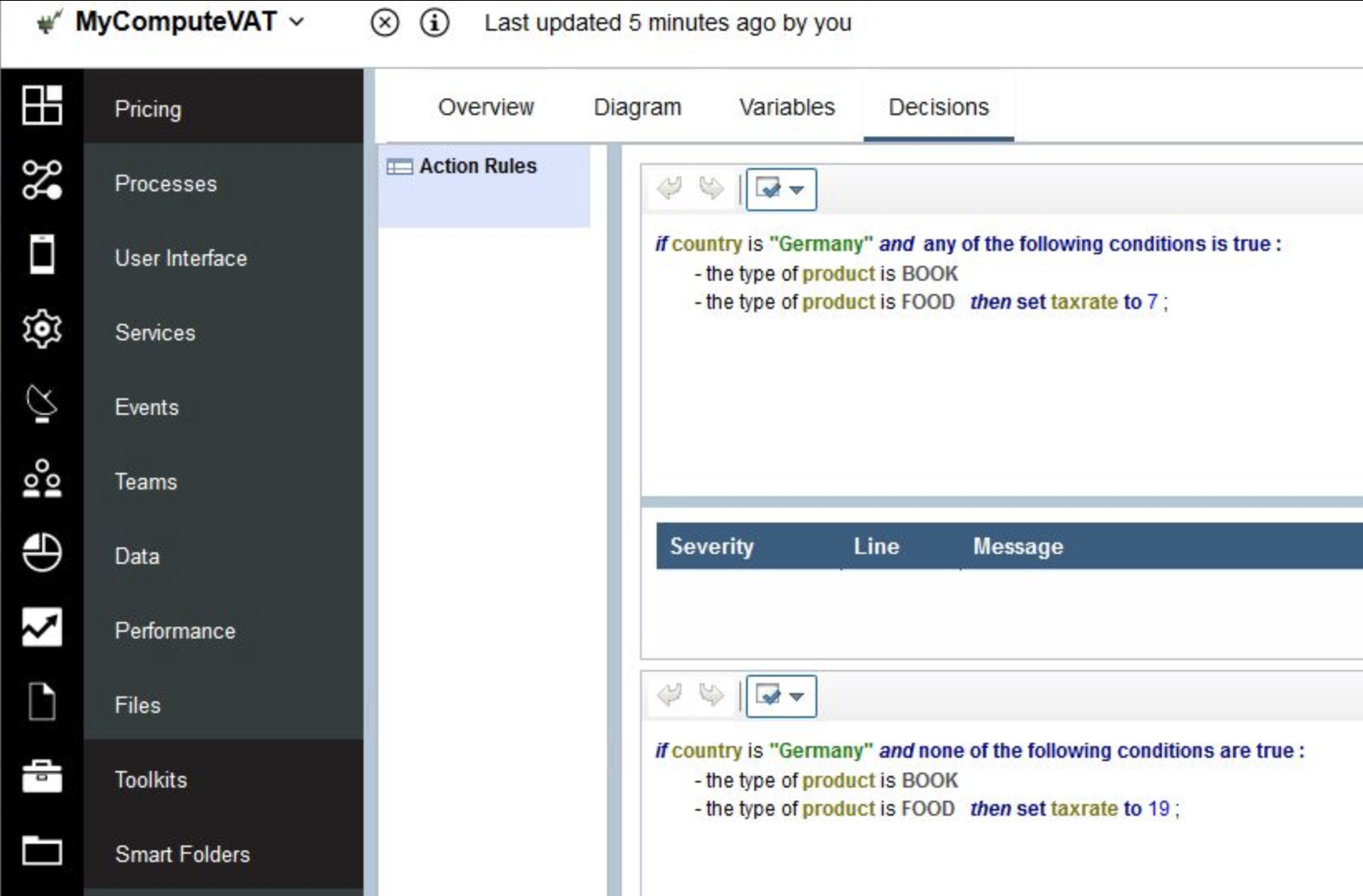

Click on Decisions at the top and then on Action Rules in the left hand navigator. The decision action rule editor opens and shows an if
<condition> then <action> rule and a message that the rule is incomplete.
Click on <condition> and a box with choices opens, choose country, press the spacebar and then CTRL-spacebar; another choice box opens, choose is <an object >. CTRL-spacebar again and choose <string>, enter Germany between the quotes.
Add a space after the last quote and press CTRL-spacebar again and choose and <condition>. Again add a space and press CTRL- spacebar and choose any of the following conditions is true :.
Press CTRL-spacebar again and choose -<condition>. Press CTRL- spacebar again and choose the type of <a product>, CTRL- spacebar choose product, CTRL-spacebar choose is <an
object>, CTRL-spacebar choose BOOK.
Now add a second condition where the type of product is FOOD.
Click on <action> and choose set <variable>, choose taxrate, next choose
to <variable value> and finally choose <number> and set it to 7.
Press CTRL-s to save your work.
The choice of the product type works because the type ProductType has already been defined as a Simple type of type Selection when the Pricing – Start.twx file was imported.
So far we have achieved that there is a rule that determines the VAT correctly when books or food is bought. In order to set the VAT to 19% in all other cases we need an additional rule:
if country is “Germany” and none of the following conditions are true :
An additional action rule can be added by clicking on the Add action rule rule icon, the top icon on the right hand side of the existing action rule. Use the up and down arrows to determine the order in which the rules are checked. Use the description above to create the additional action rule for all the cases where neither book nor food is bought. Press CTRL-s to save your work.
Your MyComputeVAT action rules decision should look as follows:

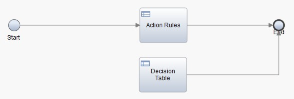

Decision tables offer a different way to model these rules which is explored now. Add another decision to the existing service flow.
If not still open, navigate to the MyComputeVAT service flow where we added the decision that was modeled as action rules. Click on Diagram at the top to open the flow editor.
Add a second decision onto the canvas by dragging a decision task from the right hand navigator onto it. Give it the name Decision Table. Wire it to the end node. Your service now looks as follows:
Click on Decision Table and then on Open Decision in the Implementation tab at the bottom of the page. The decision editor opens with an empty if-then rule.

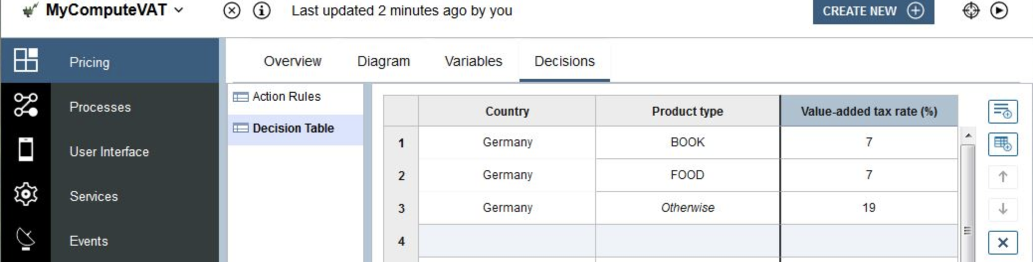

Right click on the label of the action column and choose Define column. Define the column as “set taxrate to <a number>”. Click Define at the bottom of the editor and then CTRL-s to save your work.
The tax rate per object type and country can now be defined.
Click and hold the first cell in the Country column and move the mouse down such that you mark the first three rows of the Countrycolumn.
Right click the marked rows and choose Group from the options.
Double click the first cell of the Country column and enter Germany. Click anywhere outside the cells. All cells now have the same value.
Double click into the first cell in the Product type column and choose Book from the drop down menu.
Double click into the first cell of the Value-added tax rate (%) column and enter the number 7.
In the second row Germany is already entered, so add the values, FOOD, and 7 into the respective columns.
In the third row right click in the second cell and choose Set to Otherwise from the options menu.
In the cell of the third row for the Value-added tax rate (%) enter 19.
You can check the rules for every row of the table by hovering the mouse over the row number. It is very easy to add new countries and their rules for the tax rate depending on different product types.
Your MyComputeVAT decision table should look as follows:

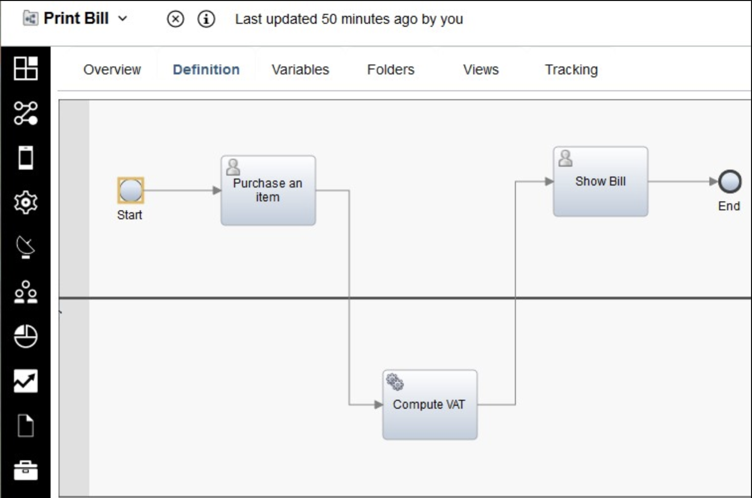

In the process designer navigate to the Processes on the left hand side and click on Print Bill.
In the Definition tab of the process click on the Compute VAT system service. In the properties section at the bottom click on the Implementation tab and select as implementation the MyComputeVAT service. The resulting VAT is the input to
the ShowBill human service that computes the prices with and without tax via a script and then displays them to the user.
As the readily made process Pricing – Start.twx was imported with the Compute VAT which has just been replaced with the MyComputeVAT service the data mapping has to be adjusted.

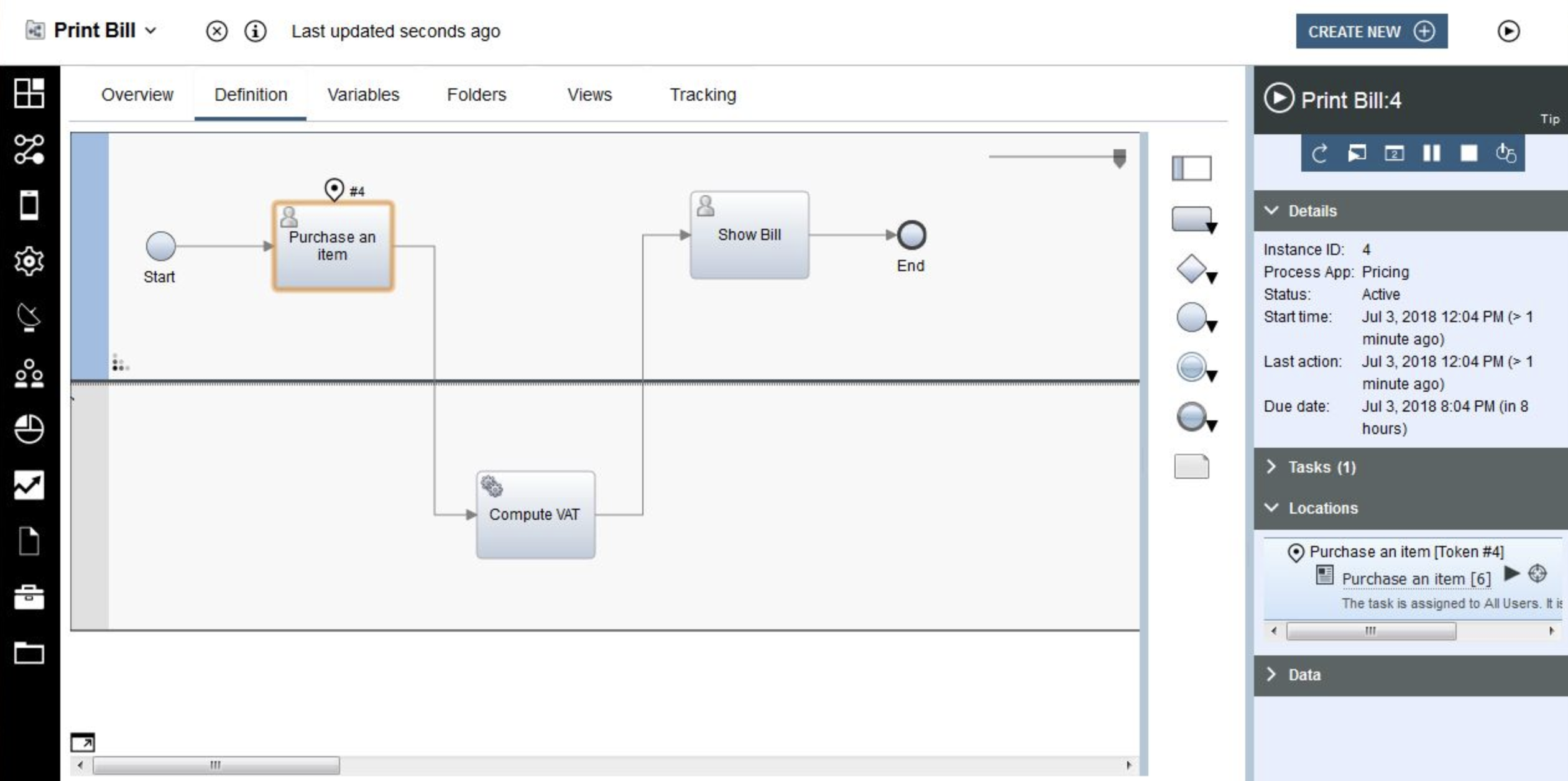

In order to try out the implementation navigate to the processes on the left hand navigator of the Web Process Designer and click on the Print Bill process. At the top of the page there is a small arrow in a circle pointing to the right that shows Run when the mouse is hovering over it. Click it to run your process.
On the right hand side new elements open, Details, Tasks, Locations, Data. Details and Locations are already expanded. The process shows a token at the position of the Purchase an item task.
In the locations area on the right hand side click on the start arrow for the Purchase an item task.
The input window opens and you can enter your information. When done click the ok button at the bottom of the page. Remember that from the offered countries you can only choose Germany as there are no rules for the other countries (yet).
The input window shows the message “The service has finished”. Close that window.
The process now shows a token at the Show Bill position. Sometimes it shows a token at the MyComputeVAT node. If that happens, click on the start arrow on the right hand side in the locations area and the token will move further on to
the Show Bill task.
In the locations area on the right hand side click on the start arrow for the Show Bill task.
The Show Bill window opens and shows the appropriate prices with and without VAT.

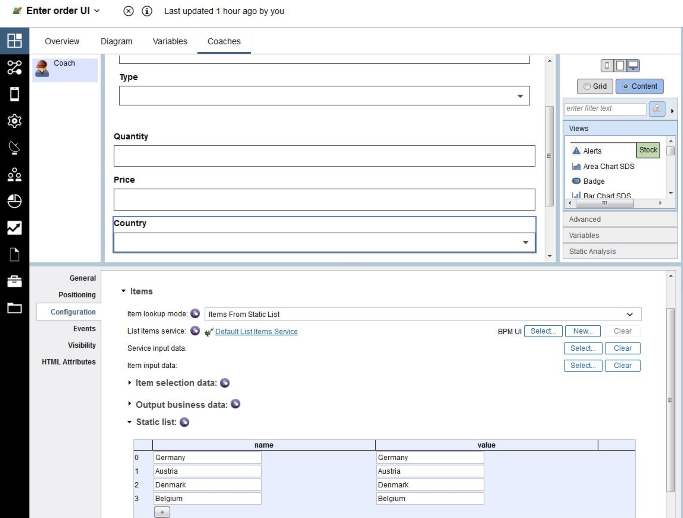

In the left hand navigator click on User Interface and then on Enter order UI. Click on the Coaches tab at the top and then on Coach at the left.
Click on Country and in the properties section at the bottom on Configuration.
From the three elements Behavior, Items, and Appearance, click on Items. Scroll down a bit and click on the twisty left of Static list.
The list of elements that are shown in the drop down box is shown and you can add more countries right there. When done save your work by pressing CTRL- s and continue with your tests.
