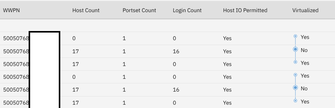

    Robert,
    If you are using VIOS and SAN switch to share the storage, it is highly unlikely you would be using the PHY WWPNs.
    Here is how you can check:
    On the FS7300 go to "Settings", "Fibre Channel Ports"
    Display the details of one of the ports
    "Host Count" column indicated something is connected to that WWPN
    If the "Virtualized" column indicated is YES, then it is using NPIV. If NO, then it is using PHY WWPN

  • 9.  RE: My BP and I need some clarification re IBM i Systems attached to FlashSystem or SVC must be converted to use FlashSystem NPIV before upgrading to 8.7 or higher
    Posted Tue February 18, 2025 10:43 AM
    We are definitely using a SAN switch
