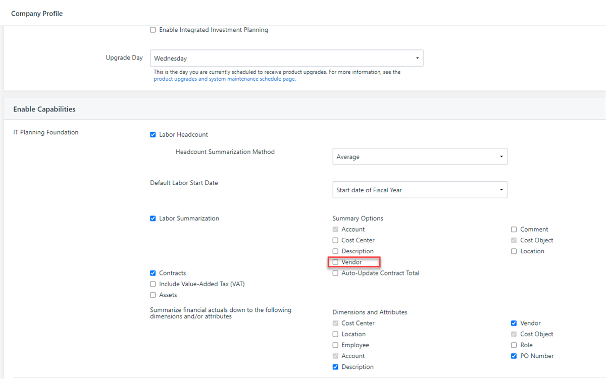

Good news! I have received an answer back from one of our ITP SME's.
Under the Gear icon in ITP (top right) there is a Company Profile option.  If you select then view the labor Summarization.  Those are the fields that will carry from Labor tab to Summary tab if selected.

@Renee Daignault Thank you for looking into this.  We do already have that checked, but labor dollars by project are from the Labor Activity tab, not the labor tab.  So we still need a way to bring in Vendor to the Activity tab.  I have a ticket out with support to help with this now.​
