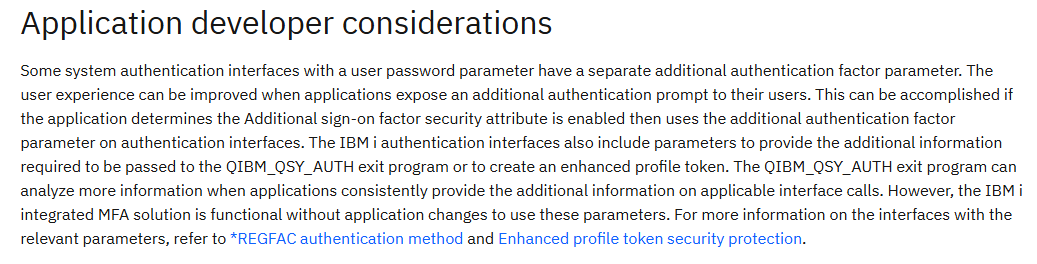

IBM’s documentation mentions an “Additional sign-on factor security attribute” that can be used to determine if MFA is enabled, and if sign on prompts should include an Additional Factor field: Additional sign-on factor security attribute
Ibm remove preview
The Additional sign-on factor security attribute indicates if MFA is enabled on your system.
Another section talks about exposing an "Additional Factor" input field if applications determine the Additional sign-on factor security attribute is enabled:

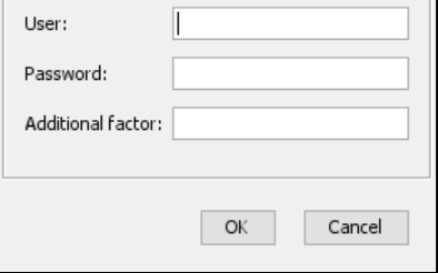

With i Access Client Solutions 5250 emulator if I attempt to sign on to a system with MFA enabled, ACS will prompt me for my username, password, and an "Additional factor" token.

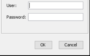

If I attempt to sign on to a non-MFA system it only displays the username and password fields
