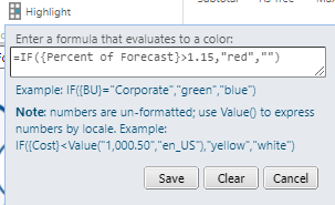

Hello! I am trying to either highlight a value in a report column with a particular color or change the text color based on that value and I am running into a few issues.
1. Is there a way to highlight a cell based on multiple values? For example, if the value is < .75 OR > 1.25 then it would be red.
2. Is there a way to include multiple colors? For example, is there a way I could use a range for the colors?
             < 75% red
              75% - 90% yellow
              90% - 110% green
              110% - 125% yellow
              > 125% red
I have played with the Highlight feature on the data tab and can work out one color, but haven't been successful with a formula that will show more than one color.

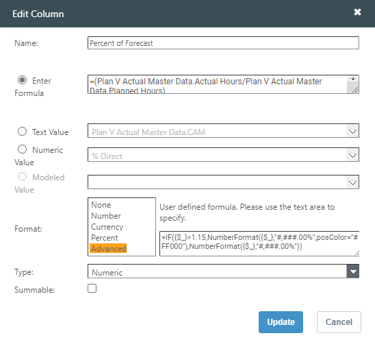

I have also used the Advanced Format for the data and again been able to successfully change the color based on one value using this formula:
                     =IF({$_}>1.15,NumberFormat({$_},"#,###.00%",posColor="#FF000"),NumberFormat({$_},"#,###.00%"))
If I can figure out some of this, that would be great. But, then I run into the issue of both not working when I add in my time columns (in this case, months). So, this is another large issue I am trying to tackle.

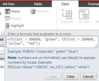

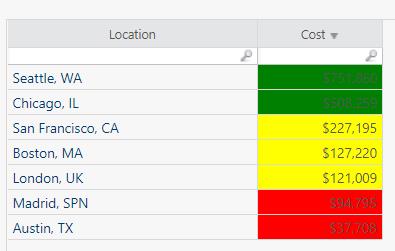

Chris Davidson's profile image
Chris Davidson  Best Answer
=If(Cost > 500000, "green", If(Cost > 100000, "yellow", "red"))

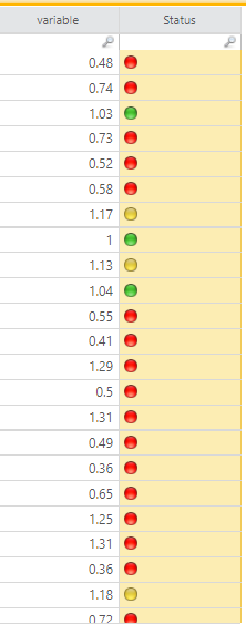

Guillermo Cuadrado's profile image
Guillermo Cuadrado
I have used the Icon() formula. In your case maybe something like:
=Icon("3colorcircles",(variable<1.1 AND variable>.9),(variable<0.9 AND variable>0.75) OR (variable<1.25 AND variable>=1.1),variable<=0.75 OR variable>=1.25)
Not identical, but the results look similar to what you want, @Abra McCollum:
(You may have to tweak the conditions and add an "=" here and there so that there are no holes).​
