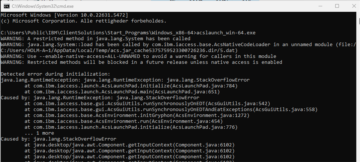

Recently I switched my OpenJDK from version 23.0.1 to version 24.0.1 on my Windows PC.
After changing the JAVA_HOME environment variable I then started my 5250 session again now running with version 24.0.1 of Java. I then realized that I could not launch SQL Script editor from the quick button panel. Then I tried to launch ACS from the desktop and it got stuck just like Jon posted.

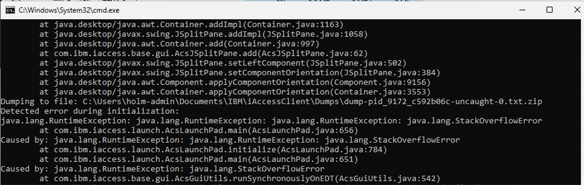

I've just tried to launch ACS from a Windows CMD prompt on a new installed test PC and the following error showed up:
A dump is produced and placed in the ....\IBM\iAccessClient\Dumps folder:
Enclosed is an anonymized version of the dump.
When swithing back to OpenJDK version 23.0.1 again the error disappears.
I hope someone can tell if it is ACS which is not ready for OpenJDK 24 or it is a bug in the jdk.

@Karsten Holm I'm having the same issue. Tried contacting IBM about this today and they said Java 24 wasn't supported and I should use one of the LTS versions (Java 8, 11, 17, or 21). 🤷🏻‍♂️
