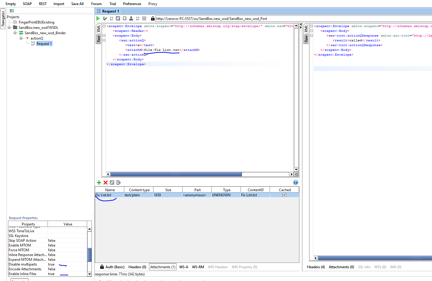

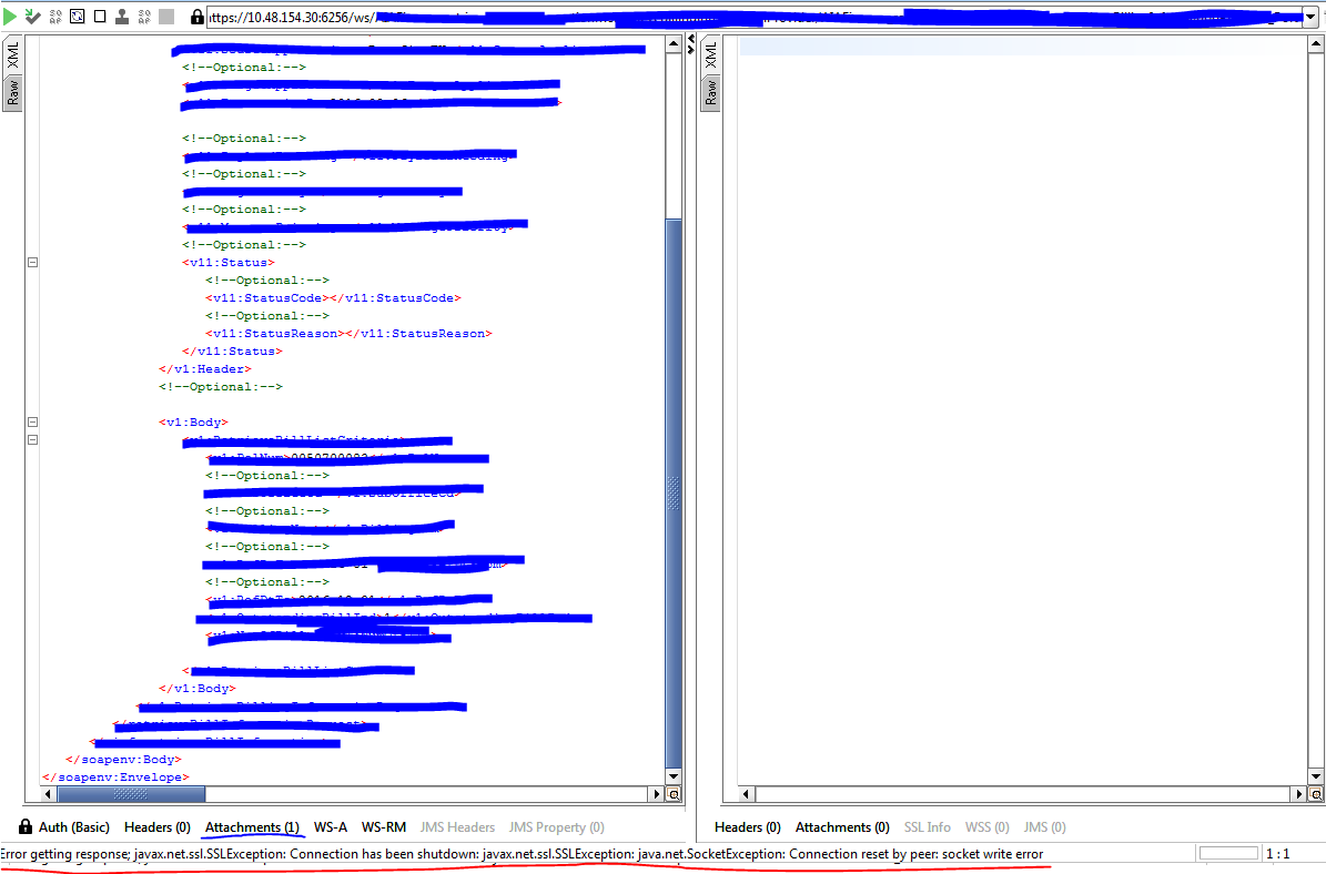

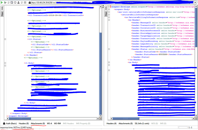

    I call some Web Service thru https without attachments in SoapUI, the web service response successfully. However, once adding attachment, not matter would be used or not in the request body, an error “ERROR:java.net.SocketException: Connection reset by peer: socket write error” will occur. May I know what is wrong with it? And how to resolve it?
