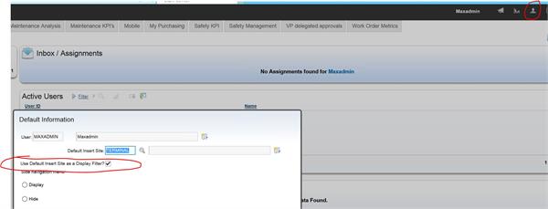

    Hi Gail,
    Yes, thinking the work history should follow the asset across sites.  workview is being filtered by design in the 'View Work Details'  to the current site.
