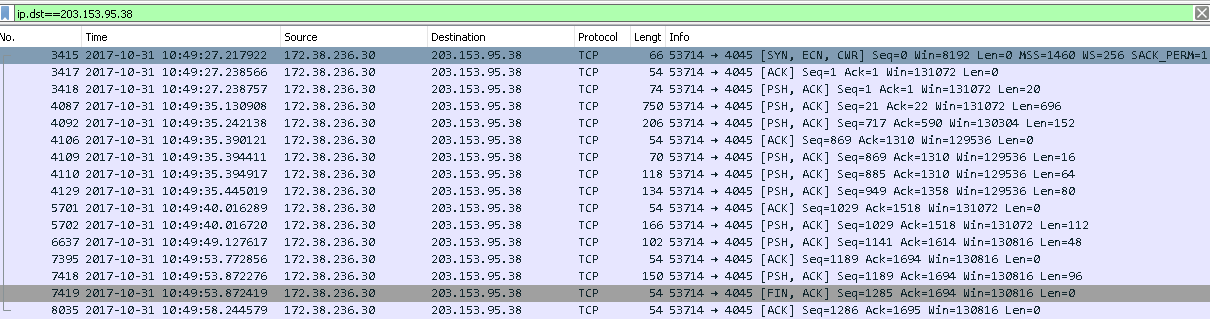

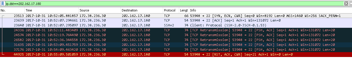

    Tried to see the packet using WireShark but found no useful information.
    We noticed when using port 22, it is tried to connect via SSHv2 while other port is using normal TCP.

    There are some application called IPS which block the SSH communication which contain the version string error/rejected.
    Since the JSCH protocol is not recognized by TP’s SSH Tectia server, the IPS assumed that this communication is not secure then drop it.
    The other protocol like WinSCP, putty and Filezilla are well recognized by the TP SSH Tectia server unlike JSCH.
    After infra team allowed this SSH: Version String Rejected, the SFTP SSH communication from webMethods to TPs are working fine.
