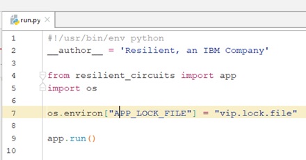

    Alternately, instead of modifying app.py to configure the lock file as described in step 5, you can perform the following:
    1. Create a file called run.py in each virtualenv folder. For example:
    2. Specify the lock file in the script. You can also specify the log_file or app config file in the script; otherwise, the run.py uses any file named run.py from the same folder of the run.py script, and generates a log file in the same folder as well.
    3. Instead of using the resilient-circuits run command, you start integration by invoking "python run.py". The python has to be the python runtime from your virtualenv.
