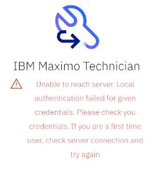

    Hello,
    has anyone encountered similar problem? When entering the URL to maximo for the first time in Technician app, we seem to be connected to Maximo as the app downloading is executed and finished. Then we are presented with login window, but cannot login. Maximo to which we are connecting uses ldap authentication, so we changed authentication to "form" instead of "maximo" in worklight properties file. We connect via VPN and maximo server is available (port 80) from the emulator from which we are connecting - we can login to maximo via browser.
    In maximo log we get nothing. The Chrome debug log snippet is attached.
    Thank you, best Regards

  • 2.  RE: Unable to reach server
    Posted 10/30/20 07:47 AM
    The problem was that the zip file, that is created when building apps was not updated with changed si.auth.type=form that we set in worklight.properties. It is not getting picked up. So we changed ..MaximoAnywhere\apps\WorkExecution\common\worklight.properties by hand for every app. Authentication now works.

  • 7.  RE: Unable to reach server
    Posted 03/21/22 05:44 PM
      |   view attached
    We are facing similar issue on Windows 10 platform with LDAP authentication.
    Issue seems to be occurring for the very first time when you do a fresh install and launch of the app.
    I tracked it down to a consistent failing behavior
    1. Install the app. If you are running in debug mode, make sure to remove the old app.
    2. Launch the app and enter credentials.
    3. You will see failure message like mentioned in above threads.
    4. Try to submit again, it will go into infinite loop.
    5. Close the app, re-launch and it will succeed for third time.
    On further investigation, during the first attempt, Server login is successful. We could confirm this by running in debug mode. Also we could see the session being established in Maximo. However something undesired is happening in localauthentication and initialization of userprofile store and collections.
