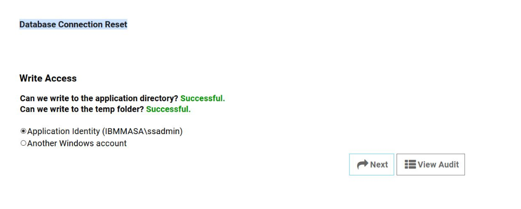

    3. Then, the port number is only changed on the TCP port level at the SQL configuration
    Change the page name, login.aspx to dbconnectionreset.aspx.
    Enter the server db name and db name ( can be verified by the MS SQL server management
    The database connection reset will require below.
    either Application Identity or Another Windows account.

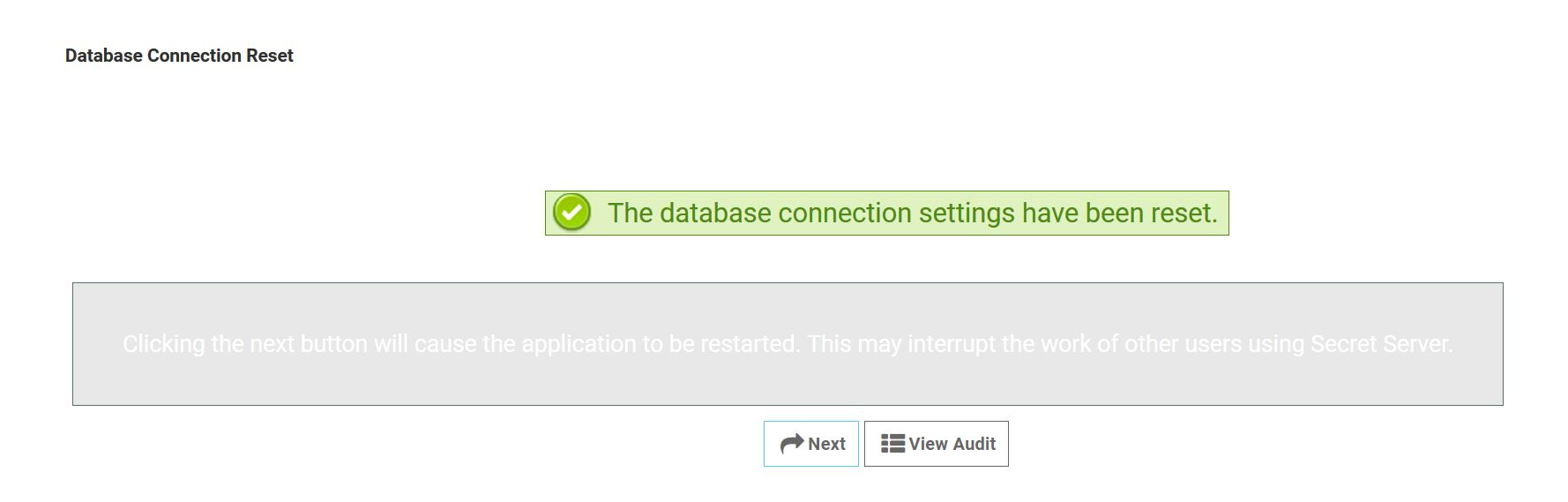

    The new database connection settings have been reset page.
    The page will warn you to restart the IIS automatically, so all users will not be access to the IBM Security Secret Server.
    I've tested below the setting, and confirmed/verified all the port changed in our Lab successfully.
    If it is not successful, please check the warning in audit link where the top page or the button for audit report.  Please open the IBM support ticket to further investigate.
