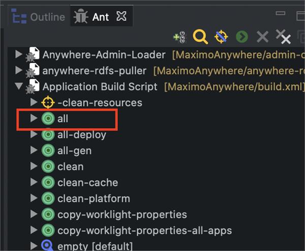

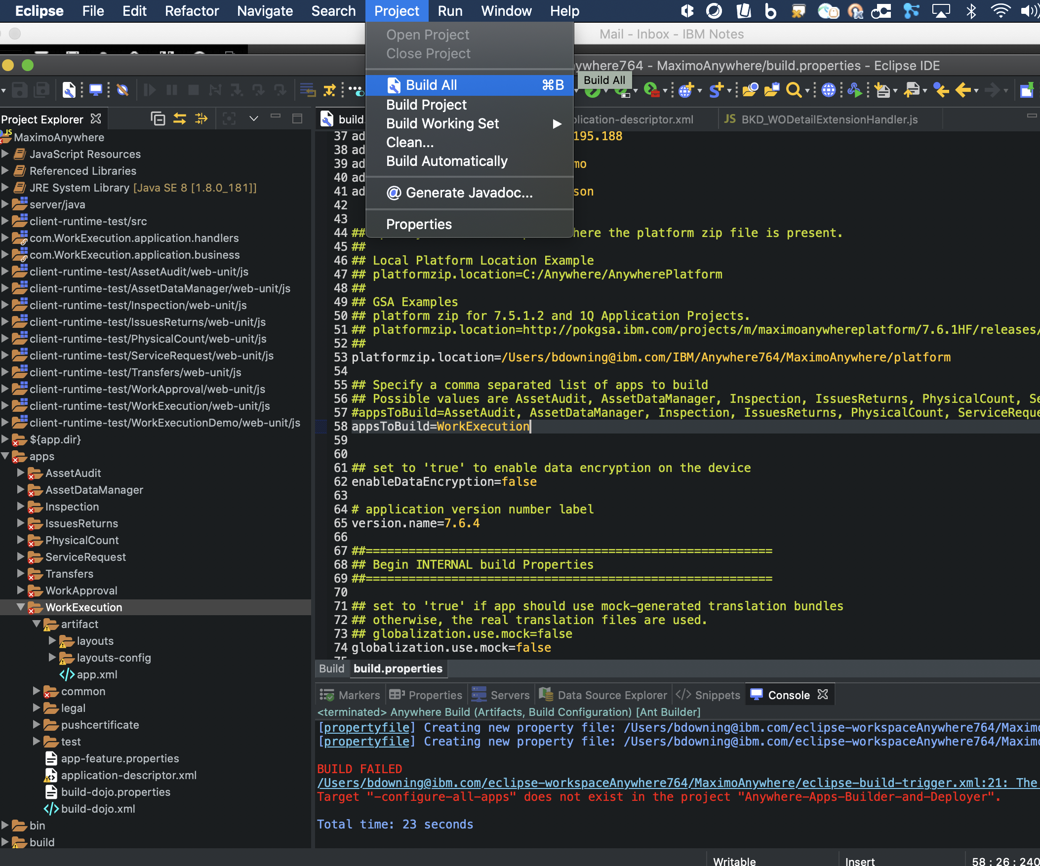

    As Steven Shull notes if you are trying to execute the build either without a target, or if you are trying to execute the specific target "configure-all-apps", then you will see this error.  Also if you just run a build from the Eclipse command "Project | Build All" you will see this error.  This is how I taught you to do the build.  That has now changed form the perspective Steven points out.  However, to a certain extent this error is misleading again fo the reasons that Steve points out.  The purpose to the Eclipse command "Project | Build All" was to work thing the confines of the IDE (see first image). Since we have deprecated the use of MobileFirst Studio, portions of the old paradigm no longer apply, (specifically and importantly the ability to run a "simulator".) You will now have to execute the Application Build Script "all" target either within Eclipse (just double-click on the "all" target, see second image) or as Steven indicates use the command window.

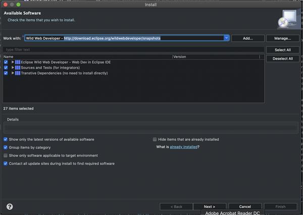

    On another note, I saw something which had previously concerned me on my environment but not any more. All the apps on Bradley's screen shot have the red error marker just like mine do. I am assuming that these are benign and nothing to dig deeper into right?

    The "little red x's" are an annoyance.  You can get rid of them by installing "Wild Web Developer".  It is an annoyance and not required. http://download.eclipse.org/wildwebdeveloper/snapshots
