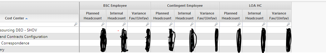

    So, I cannot get it to work the way I need it to work.
    I am attaching a screen shot.  I have 3 types of employees and I am showing Planned, Actual, and Variance for the headcount.  I need to add a third column to show the Net for each of them.  The Sum options under the Data tab doesn't produce the results I need (it's summing everything).  The formula tab options are grayed out once I have columns grouped.  If I remove the grouping I can't get the correct values to actually be pulled in, and I even tried actually creating all of the columns using the formula =if(HC Type = "BSC Emplyee......) instead of pulling them in from the Ad Hoc Query, but it's not pulling the values.
    So, if anybody has any wonderful ideas on how to get Net for these columns that would be wonderful.

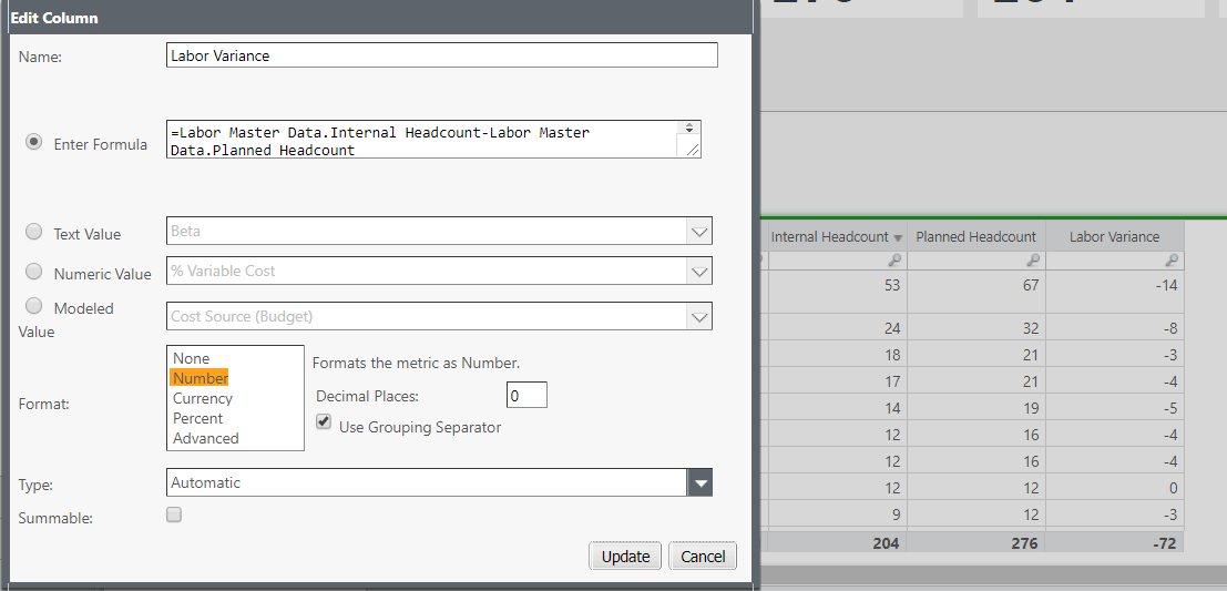

    Hi Gordana,

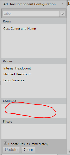

    Could you remove "Employee Type" from the "Columns" section of Ad-Hoc query.
    Then, if you go to Data tab, and include a Formula column which calculates the difference between "Internal headcount" and "Planned Headcount"
    Then, drag the "Employee Type" into Columns.
    Let me know how that goes.
    Varghese

    Hi Gordana,
    In the Formula, for the Formula column ,refer to the columns as "Table.column", ie
    Variance =Labor Master Data. Internal Headcount - Labor Master Data.Planned Headcount
    This is what I have done in the sandbox.After doing that, drag "Employee Type" to the "Columns" area.

    Thank you.  This doesn't give me what I need to do.  The issue that I have is that I need to show the Net column.
    So, I need to show BSC Employee with all the values (planned, internal and variance), Contingent Emplyee and LOA.
    Then the 4th group would be Net that displays net of planned, internal and variance.  However, once I add the headcount type to group you can't add formula column anymore. And without having the headcount type, I can't get the values to do the net.  I have tried creating formula columns for each headcount type (i.e. =if (Labor Master Data.HC Type = "BSC Employee", Labor Master Data.Planned Headcount,0) etc ) but that is not bringing in any values for me, just 0.

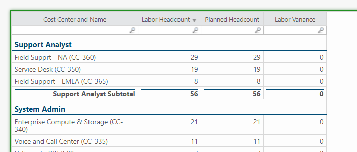

    Okay. Now I understand the requirement. Yes, once you add in that, it will not work. Have you considered changing the format of the report ?
    Below is a screenshot: In this example, I used "Position" instead of "Employee Type". I used the Sub-total option to give me the Totals of each Position, spanning across Cost Centers
    Let me know what you think.
