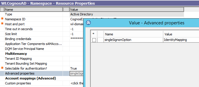

    I have Identify mapping in place. No errors, It'll ask for ID & Password on Chrome/Firefox. IE works fine.
    Mahesh

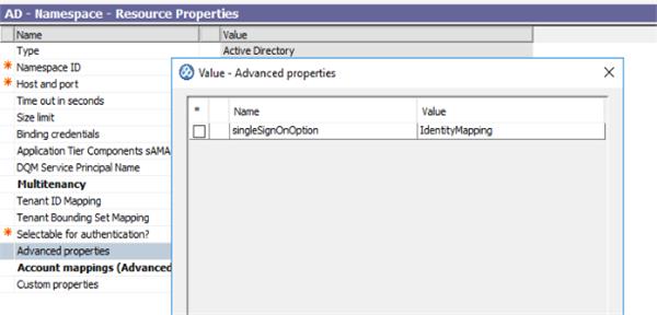

    ​My case is different from yours. Here is my SS.
    Heather Wilson
