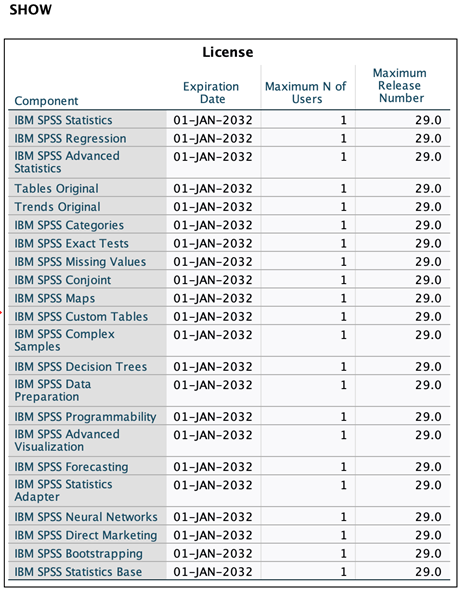

    I am having the same problem with SPSS 28 on a Mac with MacOS Monterey 12.3 - can't  open or create syntax files, can't quit SPSS without using Force Quit.
    When I click file / manage license / more information, I get the following:
    Betsy Bizot

    Hi @Betsy Bizot, have you tried yet the solution linked to above?
    https://community.ibm.com/community/user/datascience/discussion/simulation-builder-wont-open
    The problem there sounds very similar to the one you are experiencing, which may be a folder ownership issue. Please see posting #'s 10, 12, 14, and 16 in the thread above and let us know if it solves your issues with syntax documents.
    Regards,
    Curtis Browning
    SPSS Statistics Architect
  • 33.  RE: SPSS 28- Can't Open Syntax Files
    Posted 11/16/22 10:36 AM
    Hi Curtis,
    That seems to have done it. Thank you!
    After I changed ownership of the IBM folder from root to my researchanalyst account, it still shows something different from the other folders. See below. I don't know what, if anything, the "wheel" where everything else has "staff" means. (It was originally "root wheel", the sudo command changed "root" to "researchanalyst" as it was supposed to.
    But, as I said, it seems to be working now, so I'm not sure that discrepancy matters.
    Thanks
    Betsy
