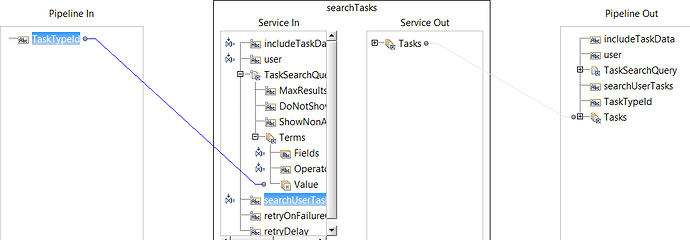

    Ok, so a first problem has arisen.
    Right now I’m just trying to get all tasks of a certain type, not minding status, creation date, …
    [/i]
    [img]includeTaskData = true
    user = Administrator
    searchUserTasks = false
    TaskSearchQuery:
    Terms = TaskTypeId
    Operator = ‘=’
    Value = FA7D47F0-B165-3E2D-3F68-958809FB5A5C (from Task Engine Administration)
    When I run this setup the output variable Tasks is empty but when I use ‘status’ as value for Terms and ‘completed’ as value for Value I’m getting results back…
    Any idea why?

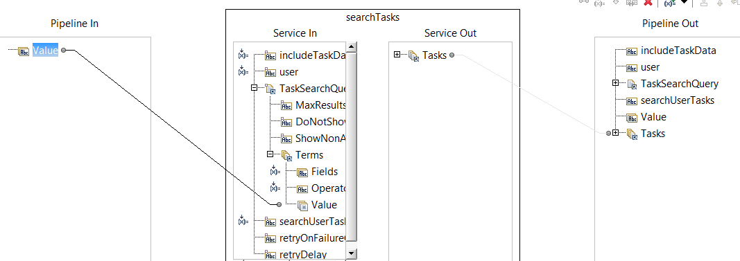

  • 12.  RE: [SOLVED] Send Task Notification E-mail weekly
    Posted 05/14/14 12:17 PM
    Ok, I fixed my previous error by using name instead of taskTypeID. This gave back the results I was looking for, but now when I try to search for name and status I get an error.
    Setup:

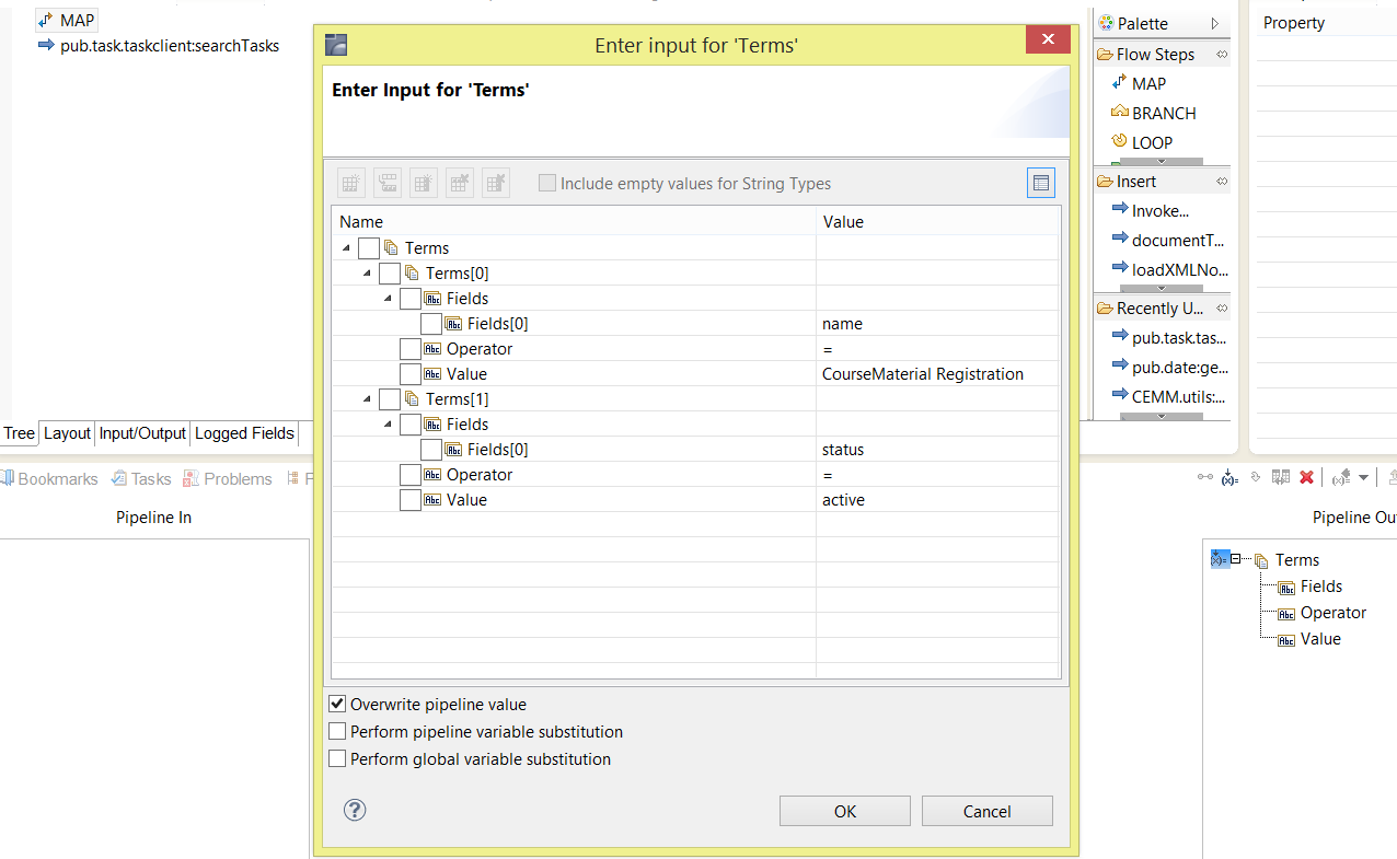

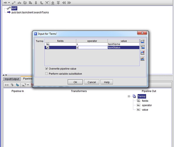

    for setting the terms the document list needs to have correct value. what I mean is:
    terms[0] = 1st search criteria(task name or Id)
    terms[1] = 2nd criteria(status)
    and not like
    terms[0] = fields[0] = 1st criteria fields[1] = 2nd criteria.
    I am not able to picture it so let me know if this is not clear.

  • 15.  RE: [SOLVED] Send Task Notification E-mail weekly
    Posted 05/15/14 05:36 AM
    what I mean is each element of terms document list should have a single criteria. see attachment if it can be clear from that.

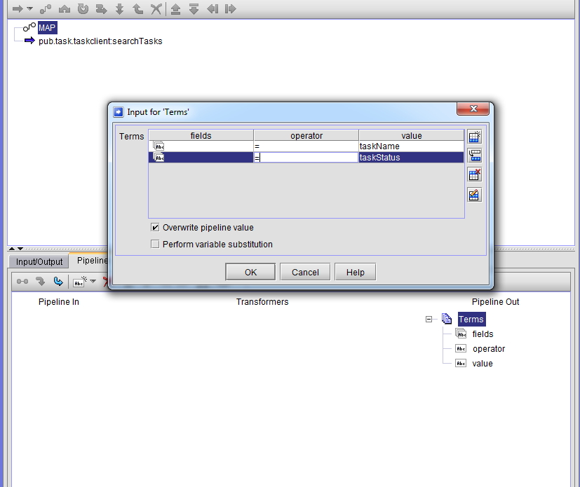

  • 16.  RE: [SOLVED] Send Task Notification E-mail weekly
    Posted 05/15/14 06:02 AM
    Like this?
    #MWS-CAF-Task-Engine
    #webMethods-BPMS
    #webMethods

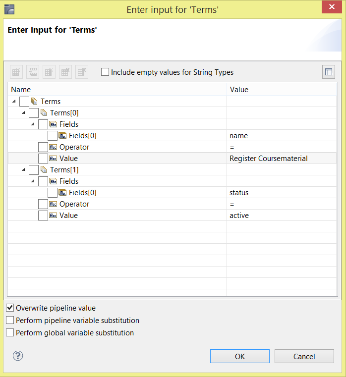

  • 18.  RE: [SOLVED] Send Task Notification E-mail weekly
    Posted 05/15/14 06:16 AM
    How about now? I changed the image in my previous post.

  • 19.  RE: [SOLVED] Send Task Notification E-mail weekly
    Posted 05/15/14 06:20 AM
    nope nothing. are you attaching it or uploading it to a URL? if its URL I might not be able to see it because of my restricted network.
    #webMethods-BPMS
    #webMethods
  • 20.  RE: [SOLVED] Send Task Notification E-mail weekly
    Posted 05/15/14 06:26 AM
    I have attached it to this message.
    #webMethods-BPMS
    #webMethods
  • 21.  RE: [SOLVED] Send Task Notification E-mail weekly
    Posted 05/15/14 07:48 AM
    yes this should work as it is working for me. did u try it already?

    Yes it works :slight_smile:
    And I was able to create the scheduling service on IS which sent my mails. So everything works as it should :slight_smile:
    Thank you for everything!
