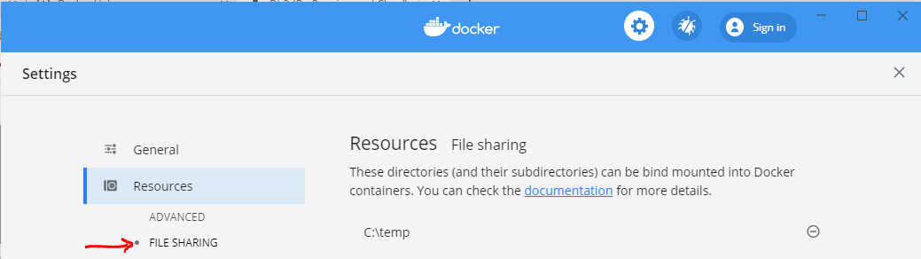

    The -v option on Docker Desktop for Windows requires additional Docker settings to be in place.  Open Docker Desktop settings, and add the file sharing resource as illustrated below.
    Gabrio Verratti
  • 13.  RE: Simple Docker DB2 image setup fails
    Posted Sun August 16, 2020 05:24 PM
    another way is using wsl2 and ubuntu bistro
    https://docs.microsoft.com/en-us/windows/wsl/wsl2-index
    you don't need ( and there is no such sreen) the file sharing above
    it works like with my favorite mac Catalina system
