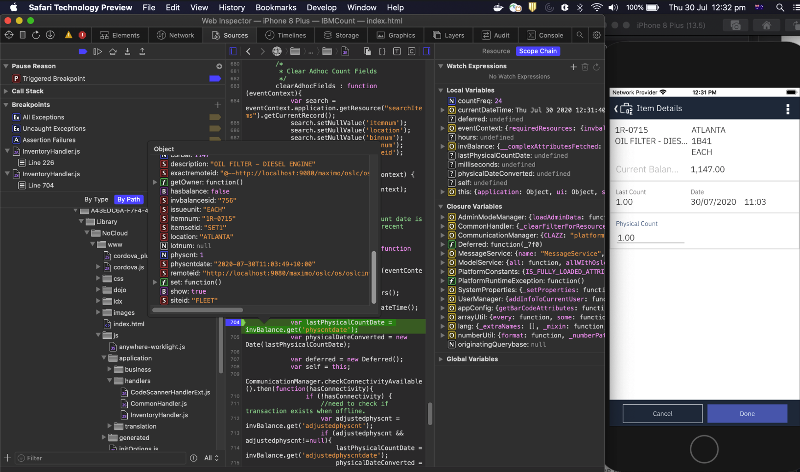

  • 16.  RE: Setup a tool like Eclipse for use with Anywhere 7.6.4
    Posted 07/29/20 10:24 PM
    Edited by System Admin 08/22/23 04:41 PM

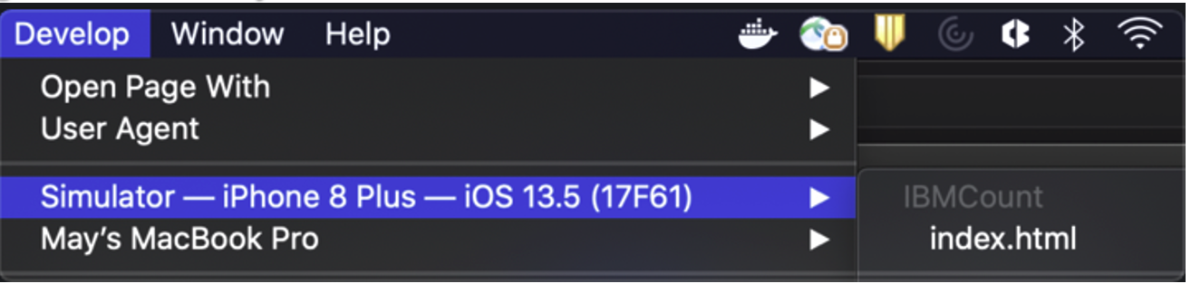

    Hi Srini,
    I am using MacOS Catalina 10.15.4
    Go to Safari menu > Preferences > Advanced then check "Show Develop menu in menu bar
    I installed Safari Technology Preview from apple website https://developer.apple.com/safari/technology-preview/
    Opened a website in Safari, Develop menu > Open Page With >Safari Technology Preview
    Safari Technology Preview opens
    Go to Develop menu >  Simulator > index.html
    Web Inspector opens
    web inspector
    Add breakpoint
    Break Point
    May On
    Tech Support
    IBM

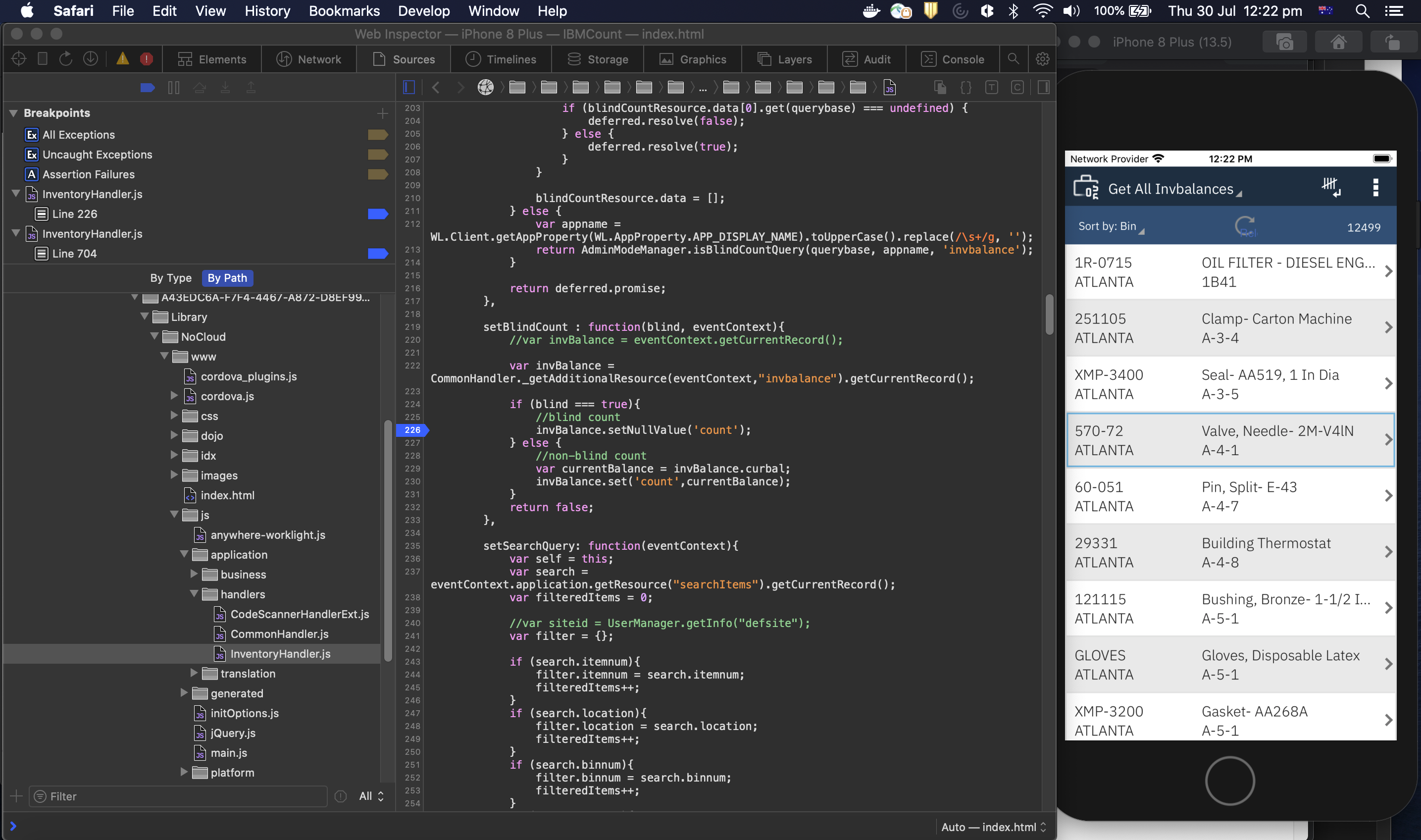

  • 17.  RE: Setup a tool like Eclipse for use with Anywhere 7.6.4
    Posted 07/30/20 08:02 AM
      |   view attached
    Hi May On,
    Installed Safari Technology Preview and able to open InventoryHandler.js in Safari. Then when I try to open with Safari Technology Preview it gave error "Safari Cant open the page.
    Attached the pic.

  • 21.  RE: Setup a tool like Eclipse for use with Anywhere 7.6.4
    Posted 08/05/20 10:25 PM
      |   view attached
    Hi May,
    Thanks for the Technote, I dont see index.html in the Simulator link after opening from anywhere\apps\physcialcount\common\index.html. Attached the pic, did I miss any step ?
    Thanks,
    Srini
    Srini

  • 24.  RE: Setup a tool like Eclipse for use with Anywhere 7.6.4
    Posted 08/06/20 08:24 AM
    Hi Srini,
    Yes, you need to open the app in XCode simulator.  Then you'll see index.html from Develop >  Simulator in Safari Technology Preview
    May On

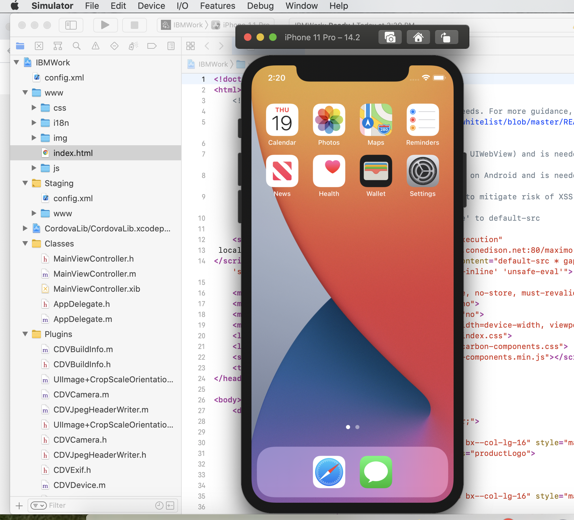

  • 25.  RE: Setup a tool like Eclipse for use with Anywhere 7.6.4
    Posted 11/17/20 03:58 PM
    Good afternoon -
    I have been struggling with this for a few days and I am hoping someone can help me along. The information in here and the tech note have gotten much farther but I seem to be missing something,
    I have Maximo Anywhere 7.6.4 and have everything installed on the MacBook I believe.
    I can see the MaximoAnywhere project in Eclipse.
    I can run the ./build.sh all from MaximoAnywhere folder.
    I can launch Xcode -> Xcode Simulator
    I can Launch Safari Technology Preview (STP)
    My issue seems to be that When I launch Xcode, I do not know what file to open up to get it to the simulator in the drop down menu. I see the Simulator itself in the STP but there is no application or index.html showing up. I guess  I am not opening the proper file in Xcode. Please help with this.
    Thank you in advance.,
    Lon Stone
    Lon Stone

  • 26.  RE: Setup a tool like Eclipse for use with Anywhere 7.6.4
    Posted 11/18/20 07:24 AM
    Try running file to view in xcode: anywherecntr\output\workexecute\platforms\ios\ibmwork.xcodeprj

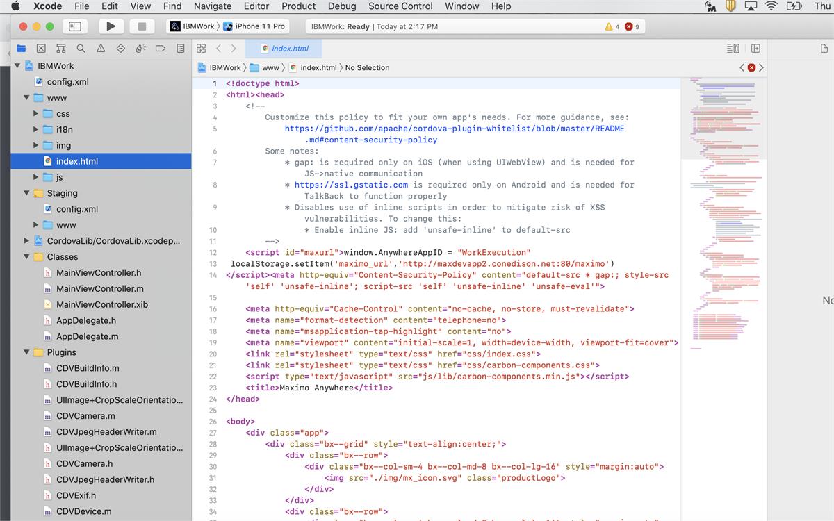

  • 27.  RE: Setup a tool like Eclipse for use with Anywhere 7.6.4
    Posted 11/18/20 11:27 AM
    Thank you for pointing me to the correct file location. I see the project in XCode. I then launch the XCode Simulator and it shows me a generic iPhone. I then Launch the Safari Technology Preview. I see in the Develop Menu drop down Simulator - iPhone 11 Pro but it does not show me the IBMWork project or index.html that I have open in Xcode. Seems like I am still missing something that links them together.
    All help is much appreciated.

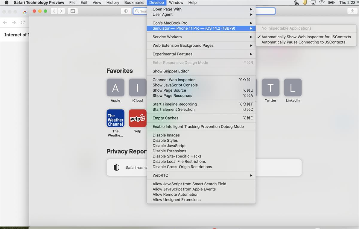

  • 29.  RE: Setup a tool like Eclipse for use with Anywhere 7.6.4
    Posted 11/18/20 08:48 PM
    Good evening -
    I am still unable to see the index.html in Safari Technology Preview. I feel I am missing some step.
    Thank in advance for any advice.

  • 30.  RE: Setup a tool like Eclipse for use with Anywhere 7.6.4
    Posted 11/18/20 08:58 PM

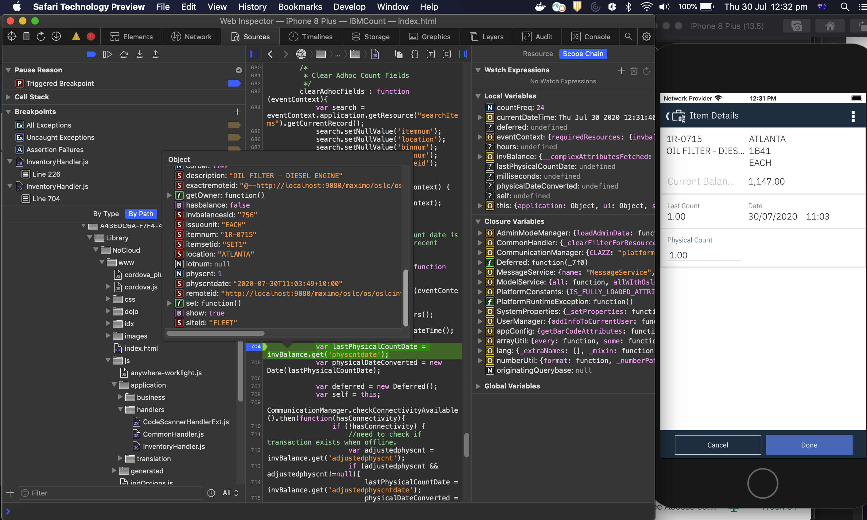

    I installed Safari Technology Preview and I got a web inspector
    I'm using iOS 13.5 as my simulator
    Then from Sources tab, select "by Path" on the left pane
    watch window comes up after adding breakpoint

  • 32.  RE: Setup a tool like Eclipse for use with Anywhere 7.6.4
    Posted 11/19/20 02:26 PM
    Open XCode and go to IBMWork project:
    Xcode
    Open XCode Simulator:
    XCode Simulator
    Open Safari Technology Preview:
    STP
    As you can see the IBMWork -> index.html did not link to either the XCode Simulator or the Safari Technology Preview.
    Thoughts?
    Lon Stone
    IBM Maximo Consultant
    The InTechrity Group LLC
    Livonia MI
    2486305375
  • 33.  RE: Setup a tool like Eclipse for use with Anywhere 7.6.4
    Posted 11/19/20 10:07 PM
    Hi Lon,
    Can you login to the app via XCode simulator?
    If you hit the run button from XCode and you get error like "/Applications/IBM/Anywhere/MaximoAnywhereAppCntr/output/WorkExecution/platforms/ios/IBMWork.xcodeproj Building for iOS Simulator, but the linked library 'libCookieManager.a' was built for iOS.", you can select the error message (those ones in red) and delete them
    Hit the run button again.
    Try to login via the simulator
    Then you should be able to see the index.html from Safari Technology Preview
