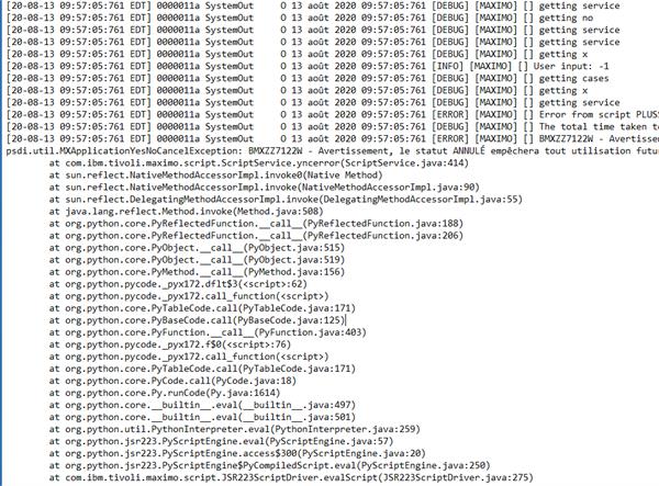

    Hi, I kept having the same result when I use the Yes No Dialog box to take the userinput.
    My script is used by a WF. In the log I have an error thrown but I don't know why ! My message is shown to the user but either he clicks YES or NO , I have -1 as an answer so neither the yes or no function is called
    Here is my code (x is always equals to -1):

    This is using the error message prompt up to get user input, so the error message in the log is normal.
    For the code execute, the first time when enter the code, which is nothing input and then call the function dflt, therefor always get -1 for the code when execute, and the correct code for get user input you need to change the function dflt code like below

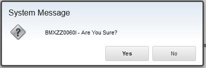

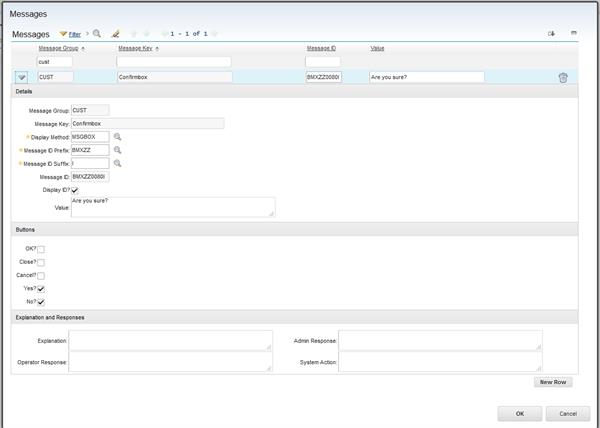

       service.yncerror("CUST","ConfirmBox")
    and also create a "CUST" message group with "ConfirmBox" under message on database configuration.
    that you will see an dialog box when the script run
