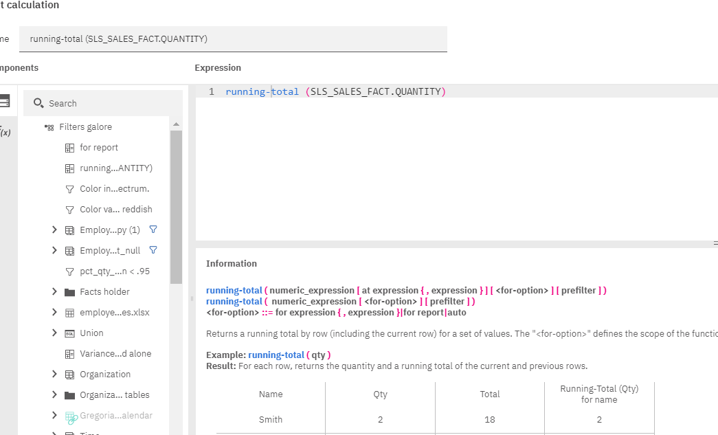

    There's the running-total function, but it occurs to me that it is possible that your question is actually more complex than that and, consequently, you might want to describe in more detail what problem you are encountering.

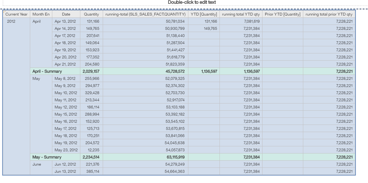

    Here's a fragment of a list report for a CA server where the as of date is April 15,2012.
    It has a calculation which uses an expression which calculates the running total of the YTD relative time measure of a measure and another one which calculates the running total of the prior YTD.
    running-total ( SLS_SALES_FACT.QUANTITY.YTD)
    IAN HENDERSON

    https://community.ibm.com/community/user/businessanalytics/blogs/ian-henderson1/2019/10/17/cognos-analytics-modelling-expression-editor?CommunityKey=6b10df83-0b3c-4f92-8b1f-1fd80d0e7e58&tab=recentcommunityblogsdashboard
    Here is something which I hope helps you work with the expression editor to achieve your aims.
