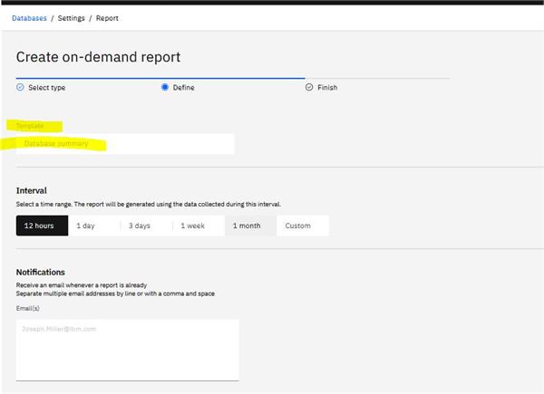

    If I build a report I see this:
    template
    there is any way to change template or build a custom template ?

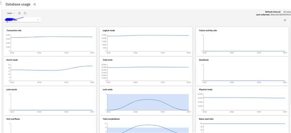

    Or build something like this:
    db_usage
    Should be useful an option to download  or print option for  monitoring report (no print from webpage)

    DMC 314 already supports KPI customization
    The screenshot above shows the customizable KPIs for the database performance Report in DMC 3.1.4. And we are developing more customizable KPIs.

    so it seems to me that upgrade to DMC 314 from 313 failed , more or less
    I have no option to select KPI or other  from Create_on_demand_report

    Your 'Create on-demand report' page dose seem to belong to dmc 3.1.3, 'Customize report' panel is not shown. You can confirm your current version of dmc by clicking 'About' in the left-hand menu, to check whether the content contains '3.1.4.0 Enterprise'. Hope to help you.
