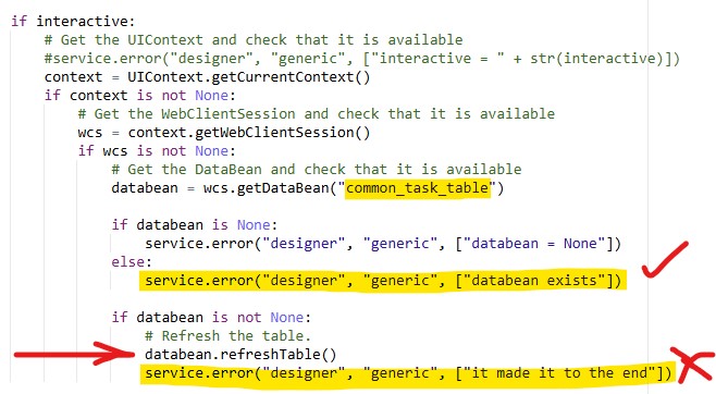

    Hi,
    I'm creating an automation script to update all the Tasks of a Work Order with the Asset of the Work Order.  I've created an action item, and the code that fires after the user clicks on the menu item seems to be adding the assetnum to each task line, as desired.
    The only problem is that the user doesn't see the changes in the UI until they hit the "Save" button.  I've tried a few methods to get the UI to refresh but nothing seems to work.
    Any ideas??

    Hi Manu,
    Thanks for sending that.  Very helpful!!  Have you tried using that code yourself.  I've modified it to fit my scenario, yet I still cannot get that Task table to refresh.  It seems to crap out at "databean.refreshTable()", as my code never makes it to the final error message I put in for debug purposes.
    Any ideas??

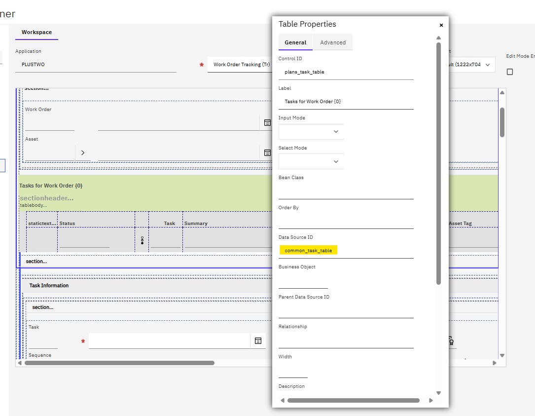

    I have not but I found another more recent post from Bruno that references the blog above too. Try the control ID maybe?
    https://bportaluri.com/2026/03/force-table-refresh-from-automation-script.html

    Thanks Manu.  Yes, I've tried a few different IDs, but still no luck.  I wonder if it's MAS v9.1 related??

    Just as an update to this, magically it just started working one day.  No code changes.....perhaps something in the browser cache was not updating??  Not sure, but anyway....it's working now.  Thanks!
