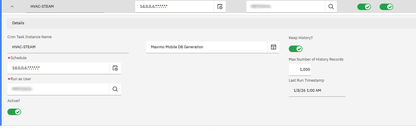

    I have a few crew work groups where the same person is the default user for them as they are the supervisor of both groups. The mobiledbgeneration cron job is reporting errors on any of these multi crew work groups where the same default user is present. What is the best way to set this up? Does each person group really need a different default user?
    ERROR:
    Crontask instance ID: MobileDbGeneration.HVAC-STEAM;
    Template user: USER;
    Template user insert site: SITE1;
    Person groups associated: HVAC, STEAM;
    Warning: The template user is present in more than one Person Group and marked as Default User.
