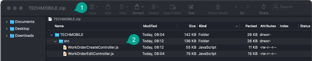

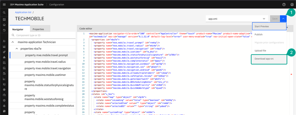

    First of all if you would like to customise existing java script file you need to download them to your local computer. To do that you can use option "Download app src" from the menu.
    In next step you can unzip the folder and customise these JavaScript files that you need (if it's not possible to achieve by doing this customisation in AppCustomizations.js).

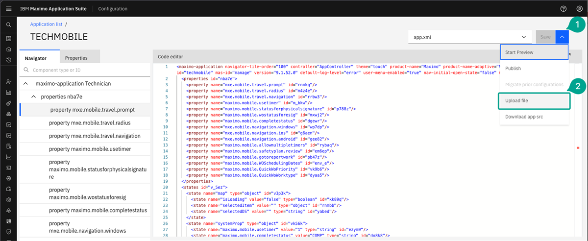

    Upload your custom changes to the project.
    To upload your changes you can zip all of your customise files (only files that you changed or added) and upload all of them at once using "Upload file" option.
    Zip folder structure should be like this [APPID]/src, for example
    TECHMOBILE/
    |── src/
    |         |── WorkOrderCreateController.js
    |         |── WorkOrderEditController.js
