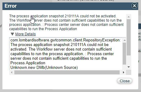

    Hi All,
    We exported an application snapshot from our Process Center and imported it in the customer's Process Center. After successfully importing it, we tried to activate the snapshot, but we get this error:
    When we create a new snapshot on the client's Process Center and try to activate it, we get the same error. After restarting the entire WebSphere environment, we get the same error.
    There are sufficient disk space (100GB+) on the database server.
    What's wrong? Why can't BAW activate the snapshot? What means "sufficient capabilities"? How to solve this?

    The SysOut.log contains the same error message like the dialog:
    [2021.01.12. 9:15:01:977 CET] 0000016e ObjectManagem E The process application snapshot 210111B could not be activated. The Workflow server does not contain sufficient capabilities to run the process application. : Process center server does not contain sufficient capabilities to run the Process Application
    com.ibm.bpm.pal.PALException: Process center server does not contain sufficient capabilities to run the Process Application
    at com.ibm.bpm.pal.action.BaseActionsImpl.validateAdvancedTransitionOnCurrentServer(BaseActionsImpl.java:776)

    It seems that there is a difference between the source and destination Process Centers: the source Process Center is Advanced, but the destination is only Standard.
    After checking which toolkits can we activate and which not, we see, that simple toolkits are activeable, but in either we added a jar file as Server File, and this toolkit (and any other toolkits or apps which use this toolkit direct or indirect) isn't activeable. No other specialities in this toolkit, just scripts using the included jar's class.
    Is it possible that jar files are not usable in Standard version, or when we create a toolkit with Advanced version and it contains jar file, it isn't activeable on a Standard version?
