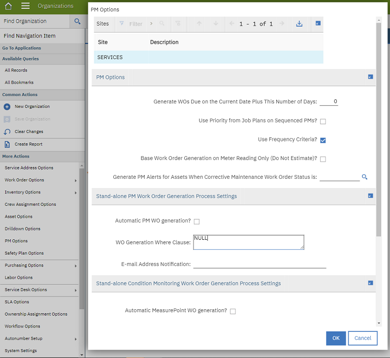

    Regarding: "You enable conditions for job plans in the Organizations application"
    I'm having trouble finding the Job Plans section in the Organizations application.
    Are you referring to the PM Options window as shown below?
    Thanks again.

    Hi
    Under organization application click on the system settings action then look on the job plan section
    Regards
