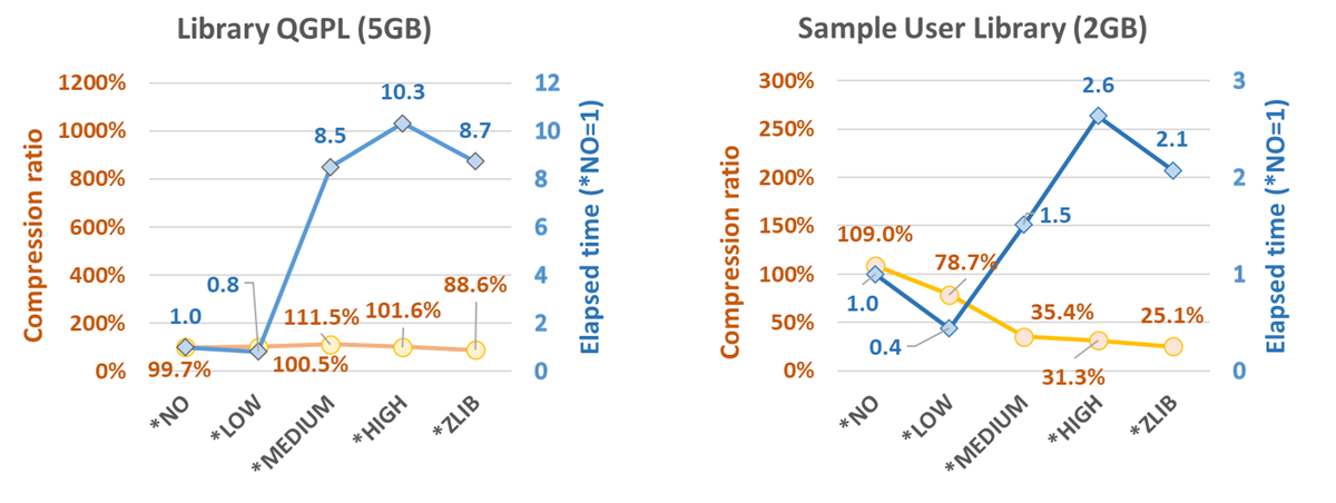

    Is there any reason to stick with *ZLIB? As others have mentioned, different compression algorithms work best for different object types, which is why multiple compression options are offered.
    For reference, here is an example comparing the compression ratio and relative elapsed time (*NO = 1) by compression algorithm in the library QGPL and in a user library where the database files occupy most of the space. Clearly, *LOW is the way to go for the library QGPL. For the User Library, the choice would be *LOW, *MEDIUM, or *ZLIB, depending on whether backup time or compression ratio is more important.
    I hope this helps.
    * Excerpted from "IBM i 7.5 and Power10 Overview" video on YouTube and translated into English.
