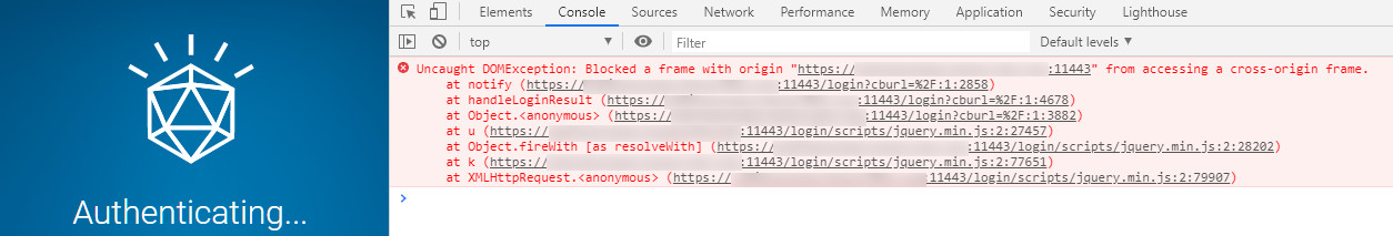

    Hello Community,
    When my users use the Planning Analytics Workspace url to login, it works fine, but when they use a hyperlink from our portal we've got the following issue :
    PAW login issue
    Any idea ?
    Thanks
    Bob

  • 4.  RE: Planning Analytics Workspace Login Issue
    Posted Fri July 03, 2020 07:58 AM
    Hi Bob,
    I don't believe it's a configuration on IBM side or Cognos Configuration. It's been a while since I have dealt with something like this but it seems to be more of a browser issue, how certain policies are brought from it's origin.
    1) does it behave the same with any browser?
    2) does it behave the same no matter what other application you are calling out from your portal?
    Again, it's been a while but I found this after digging and it almost seems like origin policies. So this doc shows some workarounds as well as ability to disable the same origin policy within the browser. Hopefully this will help. https://stackoverflow.com/questions/25098021/securityerror-blocked-a-frame-with-origin-from-accessing-a-cross-origin-frame

  • 5.  RE: Planning Analytics Workspace Login Issue
    Posted Fri July 03, 2020 09:36 AM
    Thanks Robert,
    I've been dummy not to test it on another internet browser and surprisingly it works with IE11 and not with Chrome or Firefox :-(
    So it should have nothing to do with the IBM software and I have to dig into Chrome/Firefox configuration in order to understand what is going on...
    Thanks again for pointing me to this,
    Bob
  • 6.  RE: Planning Analytics Workspace Login Issue
    Posted Fri July 03, 2020 09:59 AM
    Hello again Robert,
    In fact it's worse than I expected... it works only with IE, not with Chrome, Firefox or Edge.
    Does it mean that to provide an url to Planning Analytics Workspace we need to use the most unsecure internet browser ?
    Thx
    Bob
