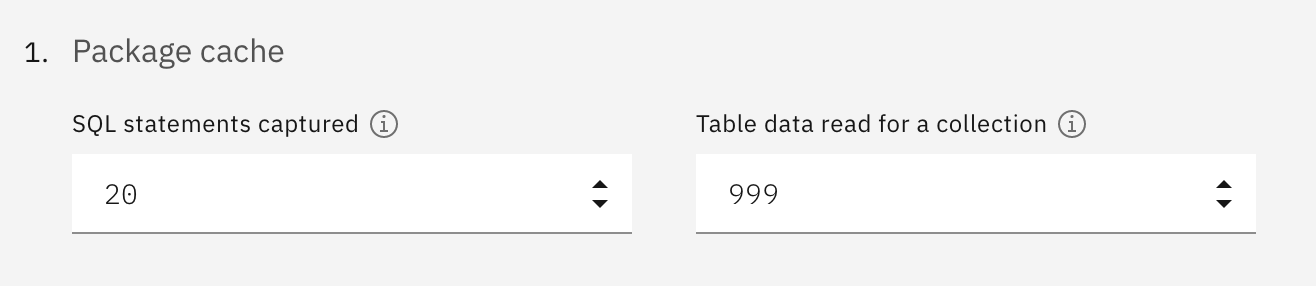

    Hi Guy,
    Have you tried adjusting package cache settings under Monitoring Profile to see if that would allow to capture more statements?

    Posted 12/23/20 02:17 AM
    yes, set to max value 1000
    but same result..
