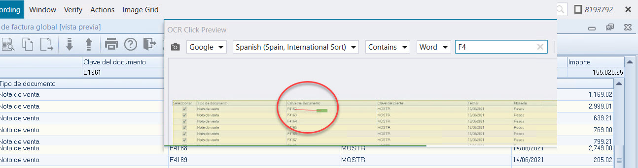

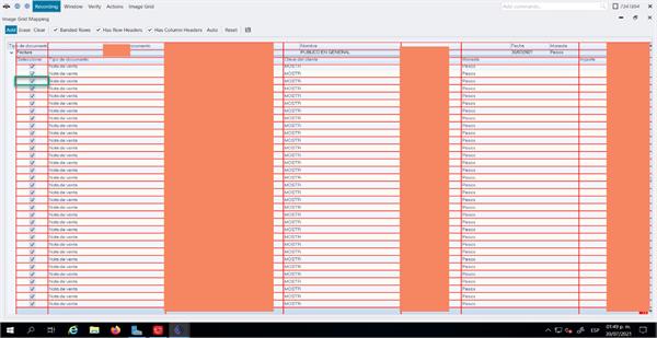

    I am creating a bot which need to work with another program and currently need the tool "OCR Click Preview" to interact with it. The problem occur when I mapped the element with I want to interact, the window in green doesn't fit with the text that is important to me. So, the click doesn't match. Is normal that the program doesn't fit? or exist some extra configuration to adjust that? Even that I was using the tools "Map image grid" and the "Click on cell" and occur the same (the click) doesn't match with the element that is relevant to the problematic I am working with.
    In the second scenario the output screen show me a well fit grid, but when I start the bot the click is gone in a different space (green box show the place I set and the result of the click)
    I show you some images to illustrate my case, expecting you can help me.
    Thank you all!
    In the image i try to find a word
    Preview of the grid with
    Result of the click (it doesnt fit with the place i set before)

    What is the monitor scaling setting? Is it greater than 100% like the image below?

    Yes, 125%. I have to adjust to 100%?

    Try to adjust to 100% and restarting Studio.
