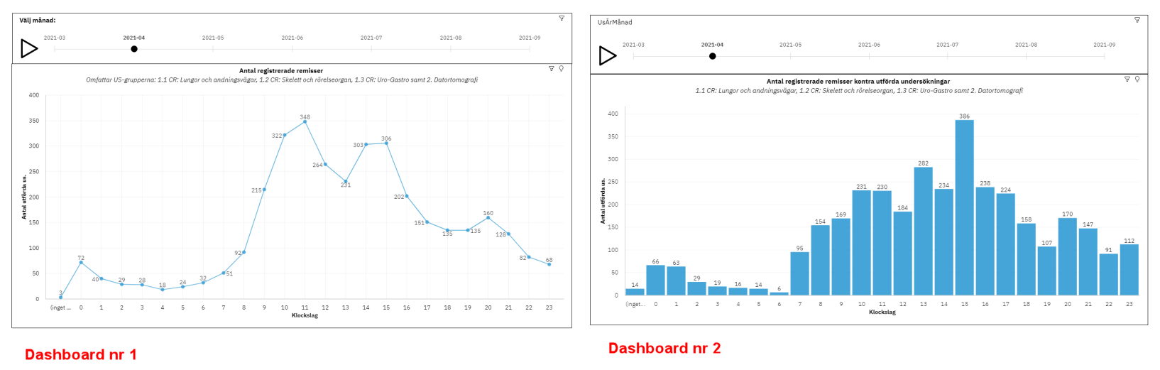

    Trying to clarify my request. I have two dashboards from the same source.
    Dashboard nr 1 is showing the numbers of incoming X-ray remiss per month, distributed per hour (exampel: during the month of august there were 112 incoming X-ray remiss at two o´clock and 155 at tree o´clock). In this dashboard I´m using a specific timestamp for the X-axis called [RemissInlästTidpunkt].
    Dashboard nr 2 is showing the numbers of conducted X-ray examinations per month, distributed per hour (00-23), (exampel: during the month of august there were 58 conducted X-ray examinations at two o´clock and 66 at tree o´clock). In this dashboard I´m using a specific timestamp for the X-axis called [UsStartTidpunkt].
    I now want to combine this two dashboards into one (visualisation using the tabel- and line diagram) and I cant figure out how the combine the two differnt timestamps for the X-axis - showing the hours from 00 to 23.
    Leif Glaes
  • 4.  RE: Merge two timestamps
    Posted 09/16/21 03:27 AM
    Hi Leif, You can create a Data Module and select the table as a source two times by using an alias/view. You each select only one time axis/column by using a different source colum for it. Afterwards you create a new table by using Union for the two source tables (remember to switch in it's default property to "keep duplicates"). Depending on your data model you might need to add calculations to make two key figures out of one (one for the line and one for the bars).
    Philipp Hornung
