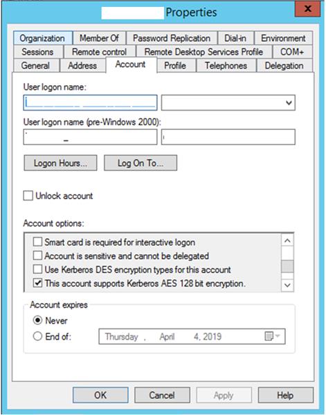

    1. The account for application server checked "This account supports Kerberos AES 128 bit encryption"

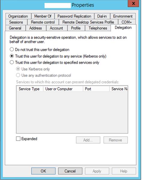

    2. The account for application checked "Trust this user for delegation to any service (Kerberos only)

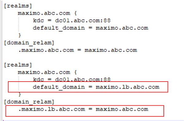

    3. change the Kerberos configure file for WebSphere point to loadbalance like below,
        assume maximo.abc.com is the maximo login address,
                     maximo.lb.abc.com is  loadbalancer address.
    The other is same as normal, it should be work.
