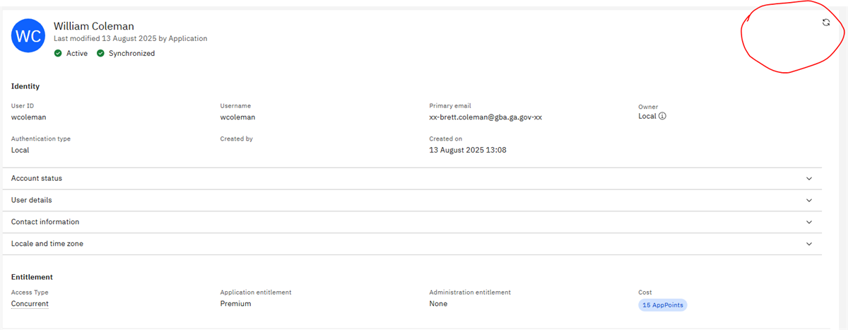

    We upgraded our dev instance to 9.1 using the same methods you described. We're currently able to log in with our admin accounts only because we had modified them in 9.0.
    However, we're now experiencing issues with user sync and have lost the ability to change passwords through the UI. While it's technically possible to update passwords directly in MongoDB, doing so by accessing the Mongo pod feels a bit cumbersome and not ideal for someone who isn't familiar with that kind of devops workflow.

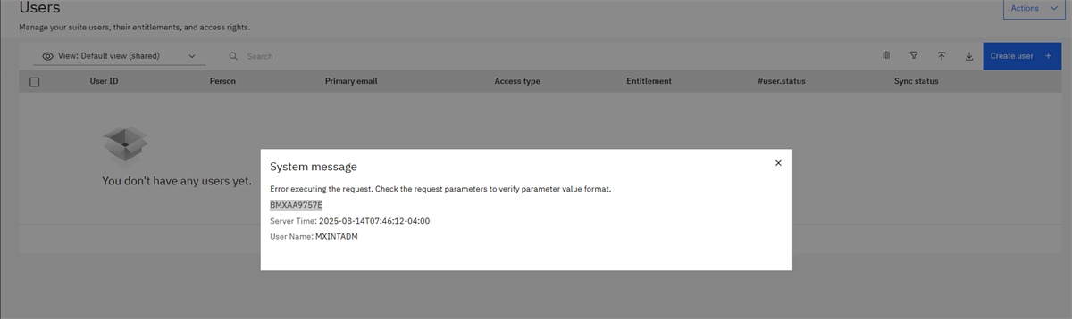

    Thanks Diego,
    IBM provided this technote for initial troubleshooting, but our maxpropvalue wasn't null, so I didn't see a need to proceed with the rsync step.
    The console is indicating issues retrieving data from the authusers table. However, I don't see a table called authusers. The closest I can find is authroleuser. When I query the table, it's empty, so that might be our culprit. I'm not entirely sure what data is expected in that table to satisfy the JS query.
