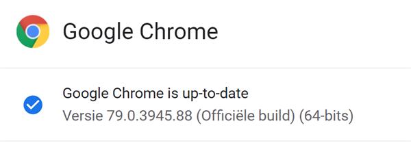

  • 9.  RE: Jupyter Notebook Kernel not found
    Posted 01/06/20 03:00 PM
    Hi Robert,
    Thanks again for your reply.
    And many thanks for the commando's I can use for (future) issue tracing :-)
    Followed your tips and I found something in the log file what could be the issue ?
    -> Blocking Cross Origin API request for .... <-
    SingleUserNotebookApp handlers:480] Blocking Cross Origin API request for /bi/v1/jupyter/user/xTERBUDp1OnVpZD1jZmJvcyxvdT1wZW9wbGU_/api/sessions. Origin: http://[Cognos Server]:[port], Host: IBM-JUPSRV2-DEMO:8000
    Searched on the internet and found some posts (https://github.com/twosigma/beakerx/issues/1963) within the Python world.
    In this post a person was trying with another browser (FireFox) and there he faced not this error.
    When I use FireFox, I also don't get this error, so looks like it's brwoser related ?
    So when I use Chroom, I see this error in de log file.
    When I use FireFox, I don't see this error in the log file.
    Before testing I did use the prune.sh / stop.sh / startup.sh scripts making sure it's a fresh log.
    1) Do you agree this could be my issue ?
    2) And do you have a direction how I can solve this so it works also with Chroom ?
    Kind Regards,
    Chris Bos

  • 12.  RE: Jupyter Notebook Kernel not found
    Posted 01/08/20 03:45 PM
    Hi Chris,
    Looking at the CORS problem in the logs, it's possible that Firefox is a little more lenient than Chrome. Here's some information with respect to CORS handling that you may find useful:
    The browser's origin (the host that you connect to) is compared to the Gateway URI value in your cognos config to verify that the request came from the same domain. For example, if you connect to cognos with http://mycognos:9300 and have 10.202.32.120:9300 for example in the Gateway URI, the jupyter server will notice that "mycognos:9300" is not equal to "10.202.32.120:9300" and will raise a CORS error. In this case, you would need to have "mycognos:9300" in your Gateway URI, OR you could access cognos via http://10.202.32.120:9300 in the browser. Both of these would solve the CORS problem.
    The takeaway would be to make sure the host and port you enter in the browser is the same as what is set in the Gateway URI.
    Regards,
    Rob
    ROBERT MCAULEY
  • 13.  RE: Jupyter Notebook Kernel not found
    Posted 01/07/20 12:59 PM
  • 14.  RE: Jupyter Notebook Kernel not found
    Posted 01/07/20 03:02 PM
    Hi Jerzy,
    Thank you for your reply.
    I did tried using the IP and not the HOST_NAME=$(hostname) setting, but with the same result.
    Perhaps I am wrong, but when Browser 1 is not working and Browser 2 is working, to me it sound not like a network issue.
    If there is something wrong on the network IP / FQDN I can understand, but than it should always give me an error, agree ?
    Right now I am more searching for Windows / Browser issue and not the Cognos (Jupyter) Server Configuration.
    Or am I missing some steps ?
    Right now it is working with FireFox for me, so I can investergate Jupyter Notebook with Cognos.
    And when 11.1.5 comes available (again) perhaps with a new fresh installation it will also working with Chroom ?
    Kind Regards,
    Kind Regards
    Chris Bos
