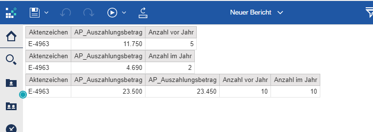

    in my project, we pay bills. I would like to have a table with for every project the amount of money paid befor 2019 and the money paid in 2019.
    I made two queries, one correctly summing up the amount in the previous years, one summing up the amount this year.
    To get these dates in a single table I want to join them.
    Then it turns out, that whatever cardinality I choose, the sums in the join mix up, when there have been more then one payment, either befor or in the year 2019:
    The first table shows, that there was 11.750 € paid in 5 payments, the second table, that there was 4.690 € paid in 2 payments.
    The third table shows the result of the join. Now it shows, that 5x4.690 = 23.450 and 2x11.750=23.500.
    Could someone here either show me a better solution to get the table I want or explain to me, what I should/could change in the join?

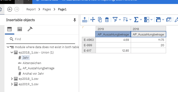

    I couldn't figure out how to get the joined query to work in authoring. I didn't spend much time trying to do as this is just break-time activity. I was able to do so in a module.
    I created a module and created a 1.1 relationship between ep2018 and ep2019 using Aktenzeichen as the key.
    But it will only work if and only if there is a value for an Aktenzeichen in each table. It is possible, even probable, the case that in your data this situation of values in only one place happens too.
    This is why you need to consider to use a union.
    I created the files ep2018_1 and ep2019_1. Each has a record for an Aktenzeichen which does not exist in the other csv.
    I added a Jahr column. It will allow you to track your time information.
    I created a module and created a union with ep2018_1 and ep2019_1
    I then created a crosstab using Aktenzeichen as the rows, AP_Auszahlungbetrage nested under Jahr in the columns.
    I think that will achieve what you need.
    I don't know the source of your data so it is possible that in source there exists similar information. Indeed it is possible that the source of your two tables has the information you need in the same table.
    I did not try to create the union in authoring but I don't think it would prove too much more difficult than in modelling.  In general, I think this sort of thing is probably better done in a modelling tool rather than authoring but that could be attributed to the  old adage, 'where you stand depends on where you sit'.
